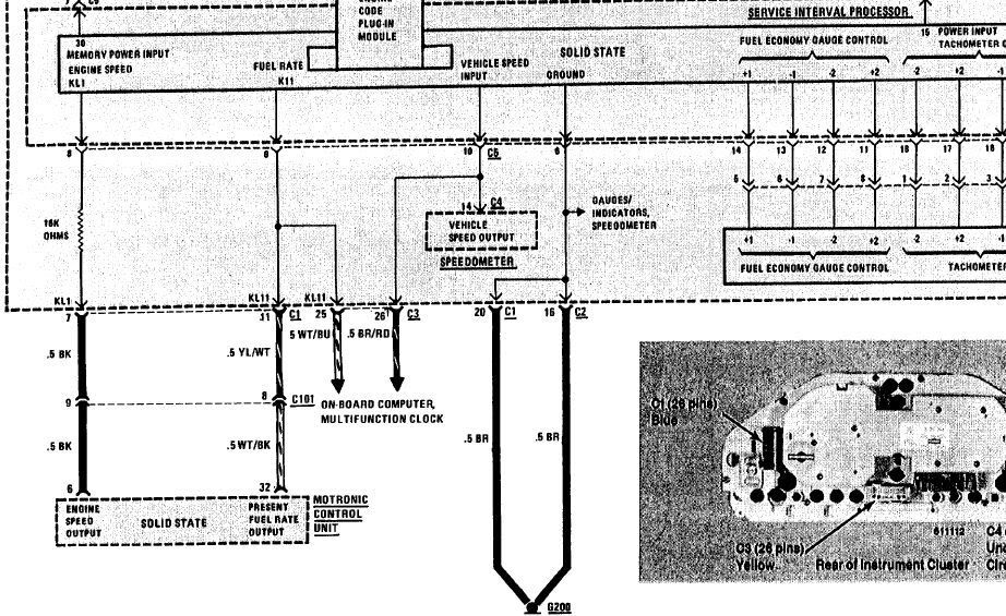

I don't have the ETM in front of me right now, but I'm pretty sure all it tells us is that a single wire goes to the OBC and Econo guage, from the motronic...but because that wire comes from a solid state component, like an IC or something ("computer chip" basically), the diagrams do not explain what sort of signal is being passed down that single wire. That's where the scope comes in. It'll show, over time, what sort of current is passing down that wire. Odds are it's some measure of fuel injector pulse, but AFAIK no one knows this for sure.

Okay. Signal comes from DME, Pin 32 .5mm WT/BK for the fuel rate, goes through the C101, and comes into the cluster via Pin 11, .5mm YL/WT through the blue plug (C1). For the RPM signal it comes from the DME through Pin 6, .5mm BK wire, through the C101, into the cluster via C1 blue plug as Pin 7 .5mm BK wire.
I don't know which wire is supposed to be the fuel rate input for the e34/32 obc. Probably Pin 24, Black/Violet wire. Dunno.
