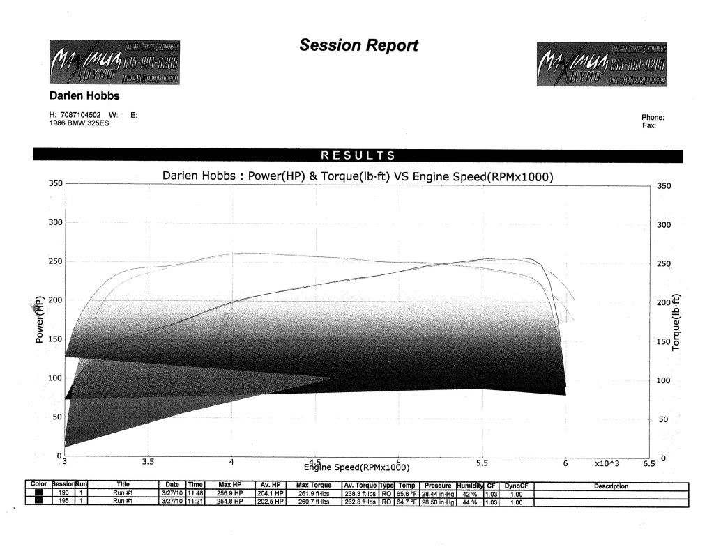

    S52 e30 Dyno results
    Well I finally had an opportunity to have my swapped car dyno'd. I don't know anything about the dyno used. I was told by the guy running the dyno that the numbers are conservative and are lower than what a dyno jet would read. After seeing Mr. Two's video of his dyno pull, I think we used the same dyno, because the people and equipment look the same.
    Final results
    256.9 hp
    261.9 tq
    Just for reference here are the facts
    '98 E36 M3 motor and trans (~90,000 miles)
    OBD1 conversion
    TRM chip
    Stock e36 exhaust manifold and cat
    AA Gen3 muffler
    3.25 final drive
    Count down to 1,000,000 miles: 490,649 to go

    Awesome! Great looking graph. That seems high though...

      /\ +1 you have some sort of freak s52. Are you sure you don't have cams or something?

        Is that corrected crank horsepower or wheel horsepower?

          I'm pretty sure that's wheel hp, because there was an S54 M coupe and an e34 M5 that put down 268 and 248, respectively, that day.
          I'll try to find out tomorrow.

            what kind of dyno?
            a dyno jet will read a little higher than the mustang dyno

              The numbers seem optimistic for the mods.. But look at that damn torque curve, or should I say flatline. Would'nt think it would have hot cams with a torque curve that flat.

                fuck me, you have a freak engine or something is wrong,.

                  why does it cut off at like 5800rpm

                    Imagine what the peak would be if he kept spinning it to 7k.. :???:

                        i cant tell if this is a dig at me or not haha. i know it probably isnt making much power after 6000rpm, but still why not run it out on the dyno

                          more power than my S52 with the full eurosport cam kit with shricks, m50, ported head.
                          just saying

                            Yep, same dyno. When I ran mine an e46 M3 put down 258whp.
                            Stock HFM?
                            After I put the motor back in the e30, we should do a pull or two :D

                              still having a tough time swallowing that one. IF the dyno is correct, you HAVE to have cams. End of story.
