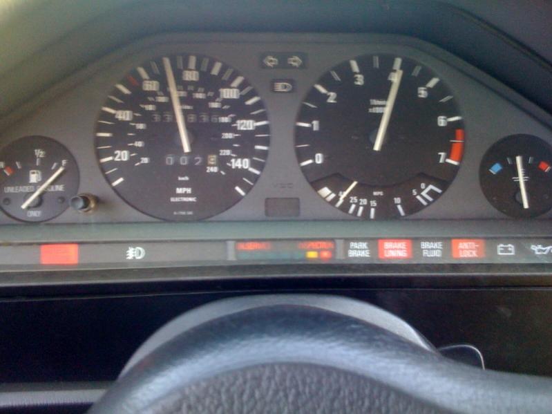

    Doh. Should have checked which diff was in the car...
    The 3.73 I thought I had would have been silly enough. That looks like a 4.10, though.
    The good news is that I should have the CEL fixed by the next time I drive it. The only thing left that's turning it on is the evap solenoid, and Yoshi dropped one off this afternoon. :)

        What trans>?
        • SpecM
          • Oct 2005
          • 4531
          Originally posted by e30_325es
          What trans>?
          with those numbers it has to be an e36 trans
            what trans>?
            zf320

                Interesting. I think I'm at 3k at 70 with a 3.25. I think you only have a 3.73.
                  Are you going to be autoxing the car? would like to check it out. I'm 30sm.
                  According to my math, 4K in 5th should 76.5MPH, while with a 4.10 it's 69.6.
                  Keep in mind that the car DID start life as an automagic.

                    automatic 325s had 4.10's so thats probly what ya got

                      What fixed the DME CEL?
                      • nrubenstein
                        • 3148
                        Apparently, knock sensors can cause that. :sigh: It's fixed now.

                          Hmm I guess I didn't realize the rpms would change that little. (although now that I think of it, it is almost a 1000rpm diff). Ok cool, I'll try to stop by and say hi next event.

                            It's a 4.10.
