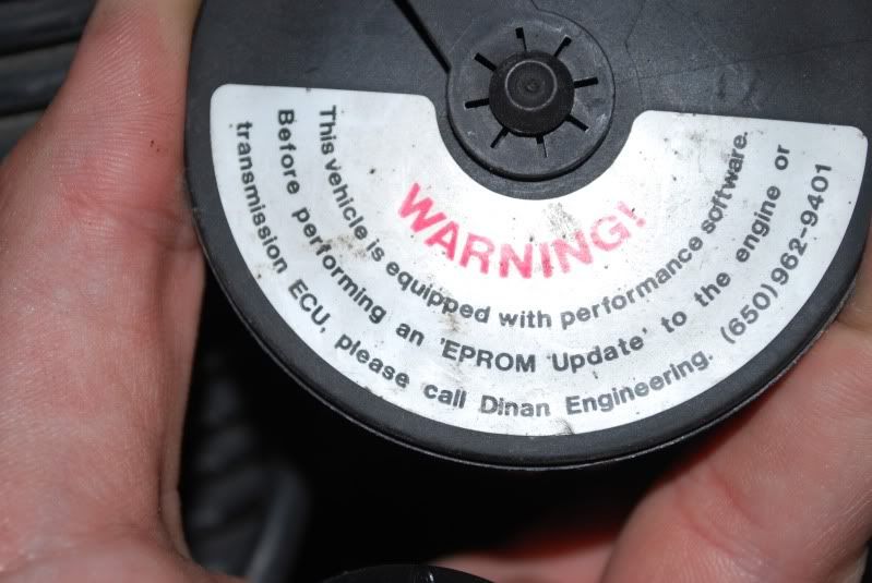

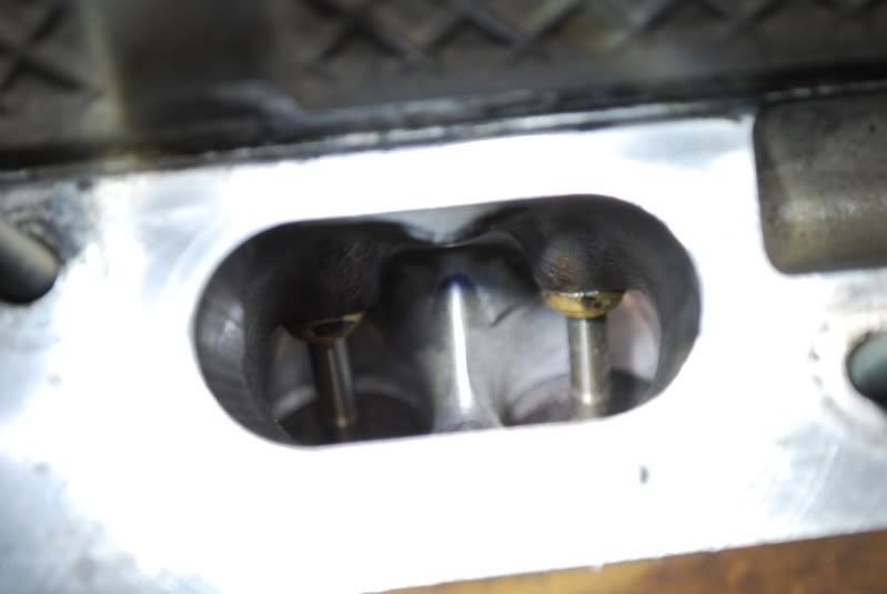

                        So I'm looking for opinions. I bought this motor without knowing much about it other than the guy telling me it was pulled from Steve Dinan's son's car and has about 60k on it.
                        The head has some machine shop markings on it, and my dad says it looks like the motor hasn't ran since the work was done, thoughts? This is looking down cyl 3's intake port:
                        Also I have this:
                        Did Dinan do anything crazy with their motors I should know aside from the ECU?

                            Thats been ported and polished for sure but nothing that should concern you.
                            @moss: 506 wasnt EWS but you are correct in the chip working with a 413 red.
                            -Alex
