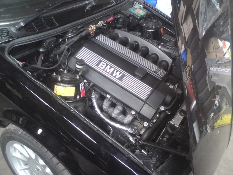

    Hoping some of you guys can help me out a bit with my conversion, its an Alpina B3 3.2 engine and im trying to run it on an S52B32 ECU, it should be running an Alpina ECU but it didnt come with one and they are nearly £2000 to buy from Alpina so I thought id try an S52 brain first :)
    The problems im having is it keeps giving fault codes for secondary O2 sensors and as a result its drinking fuel like its going out of fashion, so much in fact it will barely run at idle.
    Now the Alpina only ever had 2 lambdas up front in the manifolds, but as the S52 is a US engine im thinking it might need to see 4 lambda signals due to your stricter emissions rules, does this sound right? Is there a way to run with only 2 lambda sensors?
    As the fault code is "O2 sensor heating, open or short circuit" can I trick the ECU by giving it a circuit for the heating, or will it need to see the values from the secondary sensors also?
    Hopefully someone will know what im on about :)
    Heres a quick pic of where im at

              What gives you the impression thats an alpina motor?
              Looks like an M52 with a shrick intake mani

                The inlet manifold sort of gives it away :)
                Ive never seen am S52 up close but im assuming it is very similar

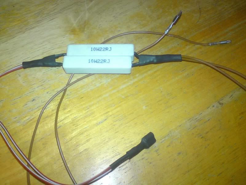

                        Lambda faults have been dealt with, I wired a pair of resistors into the post cat lambda circuit to fool the ECU into thinking it is pulling current for O2 heaters,

                          That will fix the lambda sensor heating errors, but you will still get "lambda sensor no activity" or catalyst efficiency or some other codes if you don't have real sensors plugged in. I'm actually going through this right now for a customer here in the US. You take care of one code, the next one pops up. There is no universal switch for "no more rear O2 sensors" atleast not that I've found yet.

                            But wouldnt the best signal for the ECU on post cat lambdas be no signal, ie no O2, to show the cats are working properly? Im not getting anymore codes, ive done about 20 miles, maybe I need to drive it more.
