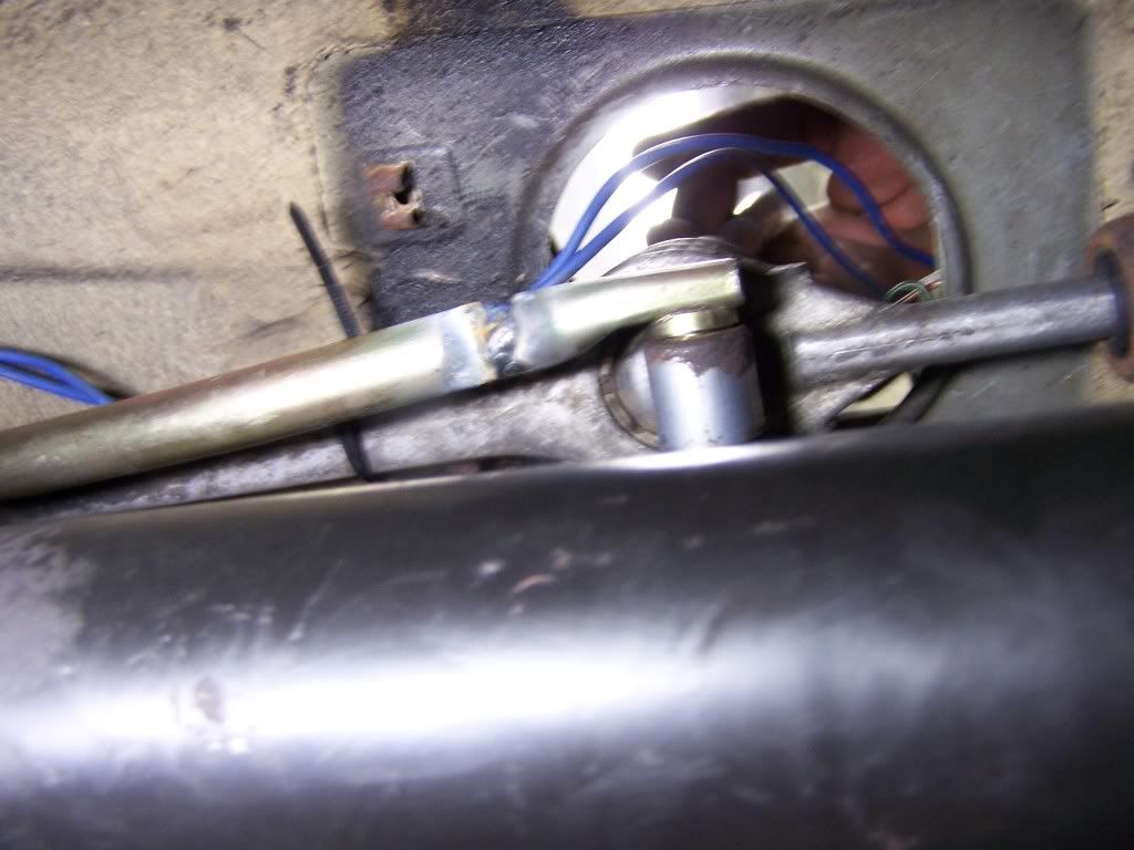

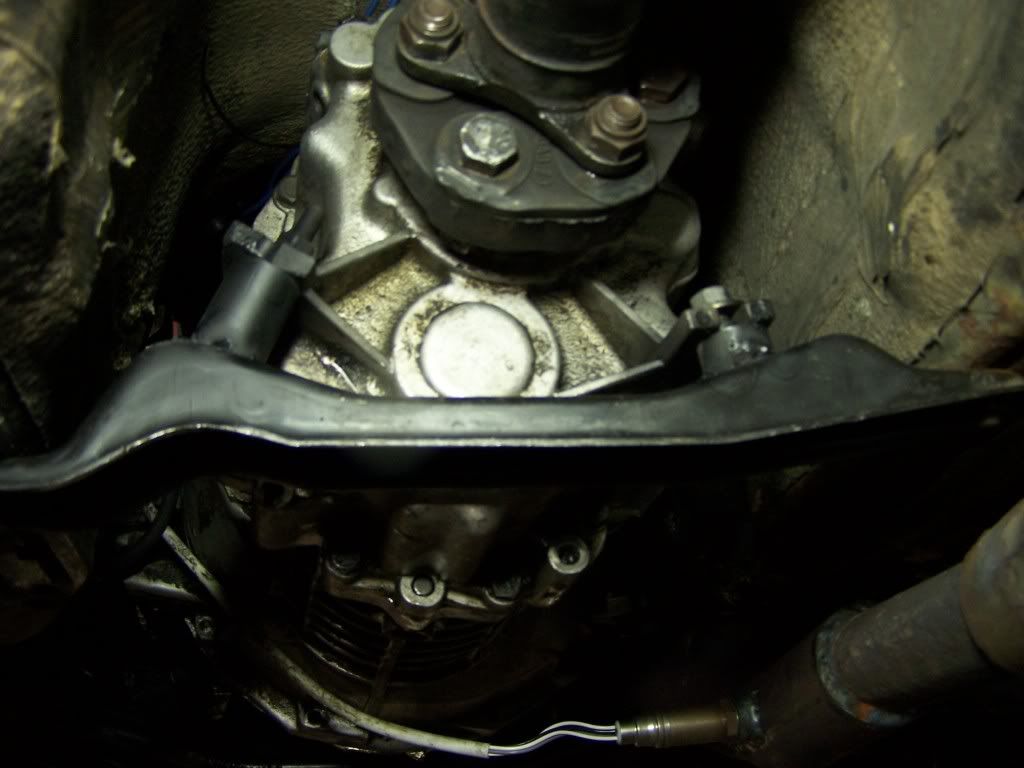

              Well we had more issues later on during the swap, the M50 gearbox wasn't working properly, so we sourced a local 260 and swapped it in. Had to make a custom mount out of the stock e30 cross member, but it all worked out in the end...
              and had to adjust the linkage so it didn't hit the tunnel when shifting...
              but even with the 2.93's she moves out pretty good!
