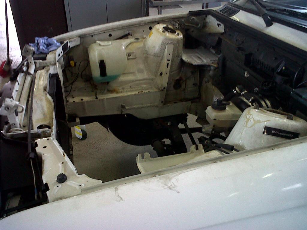

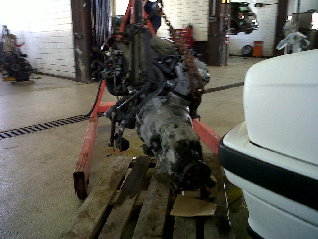

    So I started my swap today and holy sh*t; everything is so tight and hard to get to. A total PITA!!!! It'll be worth it though.

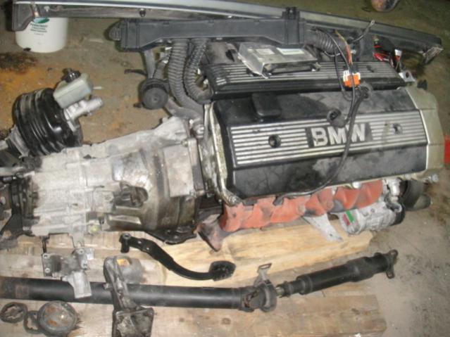

    Background: 91 316 euro spec, 94 525 engine(tu), trans, brake booster/master cylinder, appropriate mounts, etc.
    So here are the problems I've ran into so far: The shift linkage is to long by about 2 inch so I have to cut and weld it before I go to much further, The driveshaft is just the wrong size but I expected that because I'm using a ZF tranny... So I'm trying to find a 328 driveline or send the one I have to the shop to get CUT.
    The good news is the motor's in and the master cylinder out of the 525i worked! So not bad for the first day. Tomorrow I hope to have the engine ready to fire up, the linkage cut and ready to weld, the driveline out of a 328, in or the measurements ready for the driveline shop, and everything else ready so i can just put in the parts i might be waiting for. Definitely possible to get done in the next two days or so.

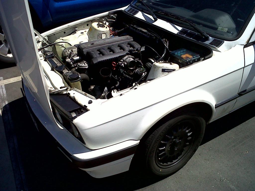

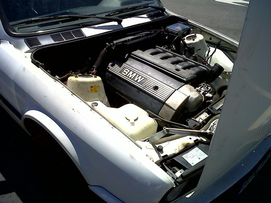

                            Pictures from today
