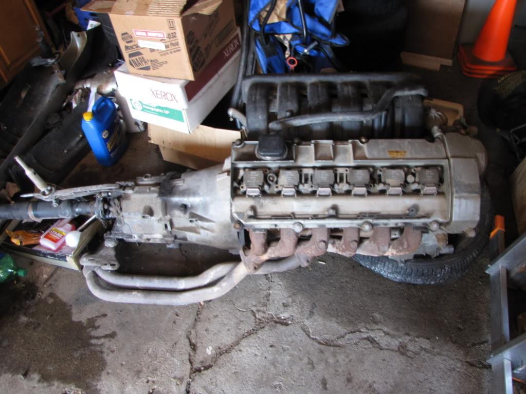

    E30 M50 swap
    I just started my M50 swap on Friday out in the middle of my getaway farm shed in the Boonies i.e. no internetz so I am playing catchup with the thread.
    The farmhouse I am staying in has no Air conditioning, no phone, and a lousy low pressure shower with no curtain. It's like camping, except camping is more convenient and more comfortable...but it has plenty of workspace to do the swap in.
    Picked up a 1994 Vanos M50 engine, getrag 250, manual wiring harness, red label 413 dme back in April from an R3Ver in Ann Arbor MI.

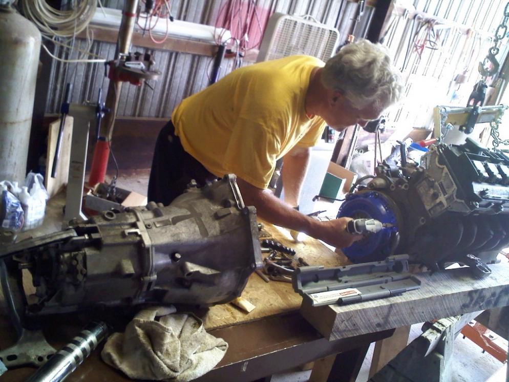

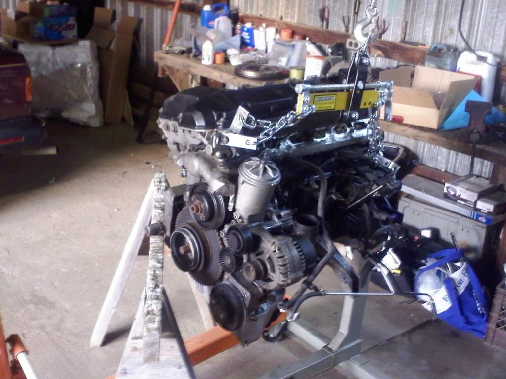

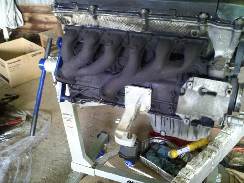

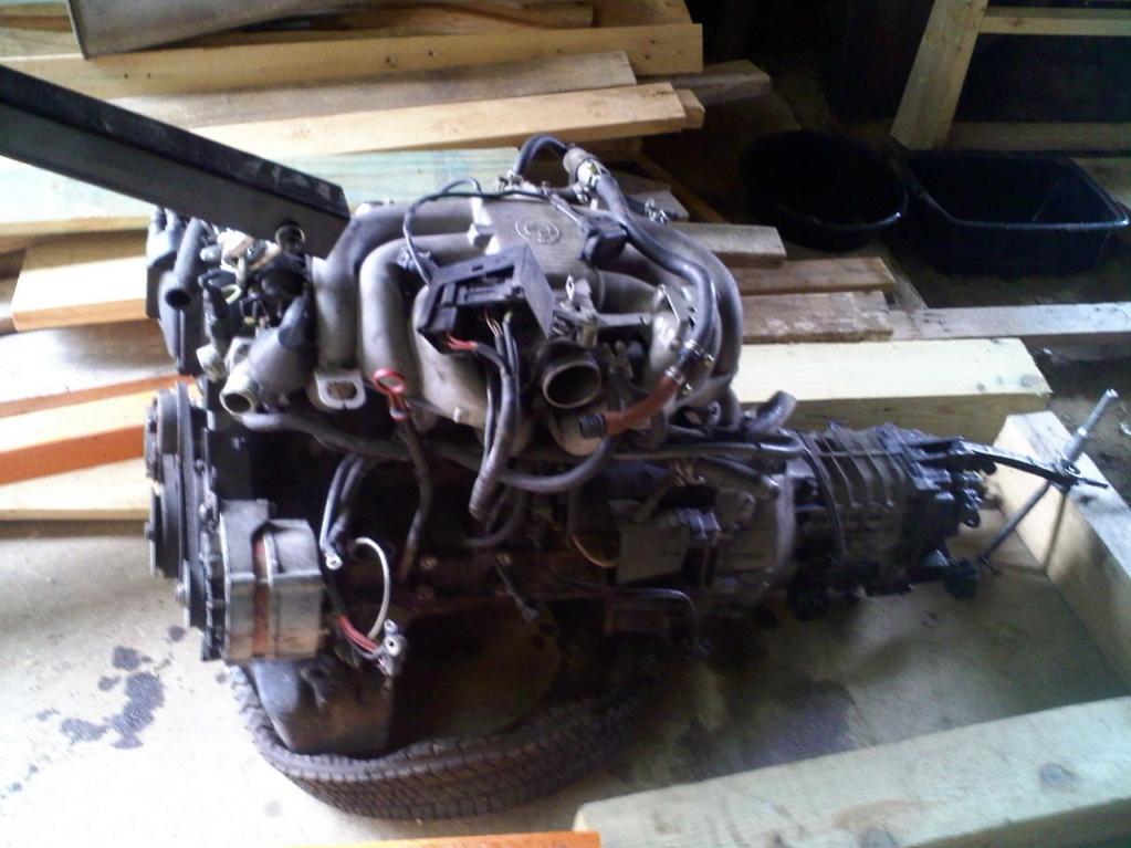

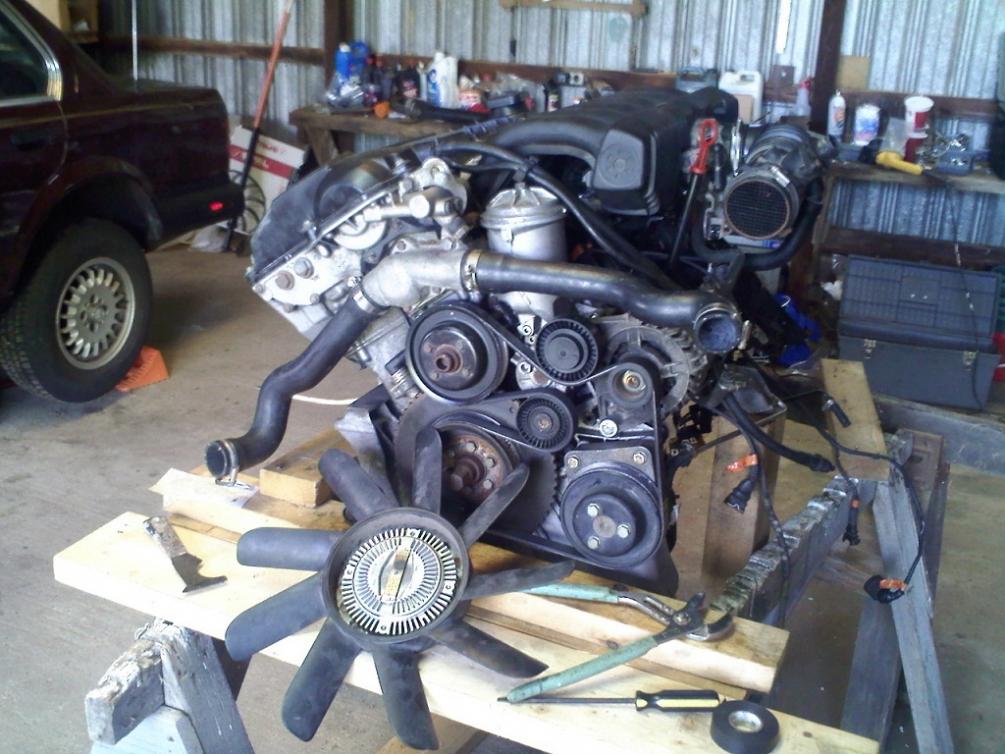

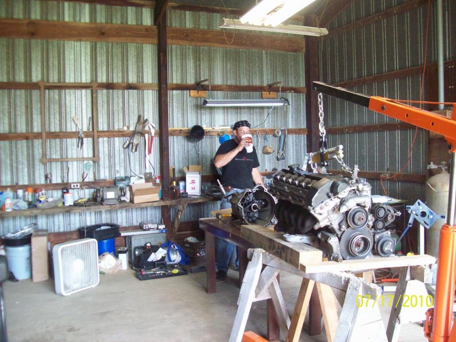

    M50 engine prep work
    The M50 engine was missing alot of accessories. All of the mounting hardware nuts bolts for alt, pwr steering, A/C, intake, you name it.
    If it weren't for Ebay, ECS tuning and Bluntech would never have got this motor back together. I know you all like detailed pics and I've got boatloads of em.

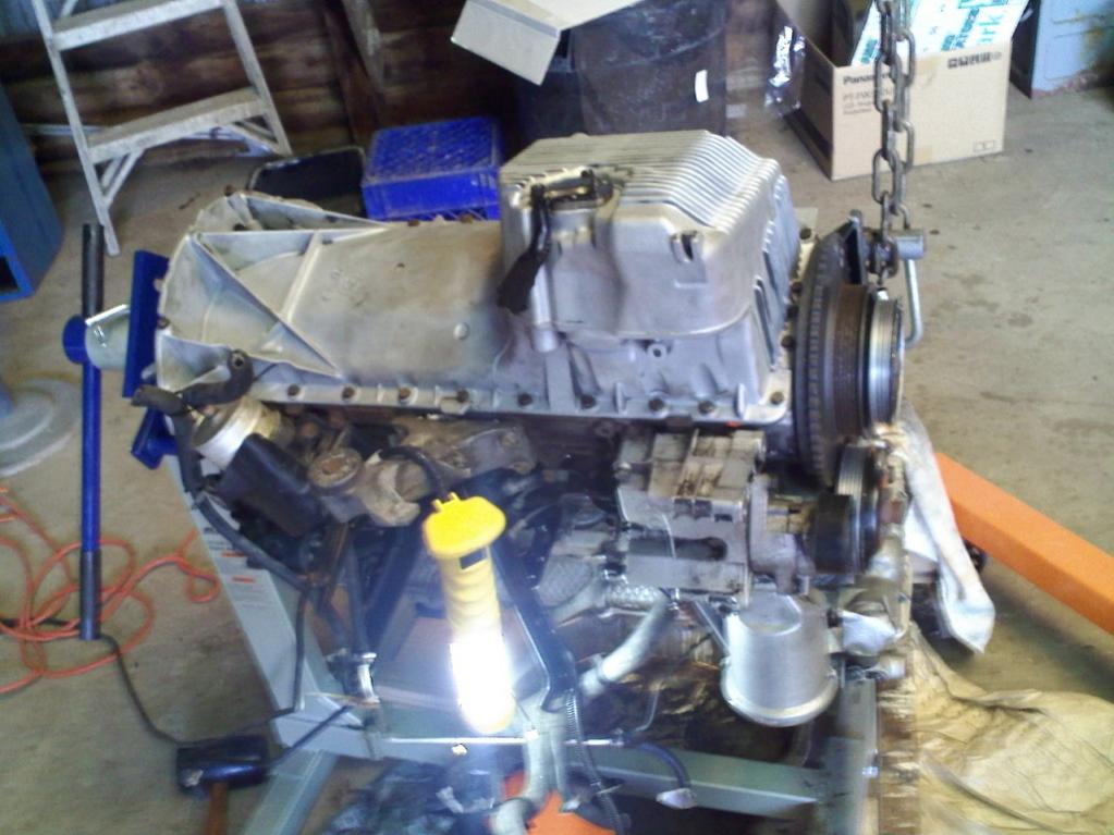

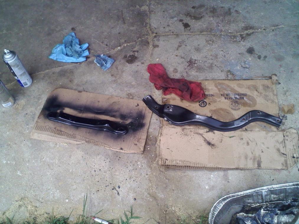

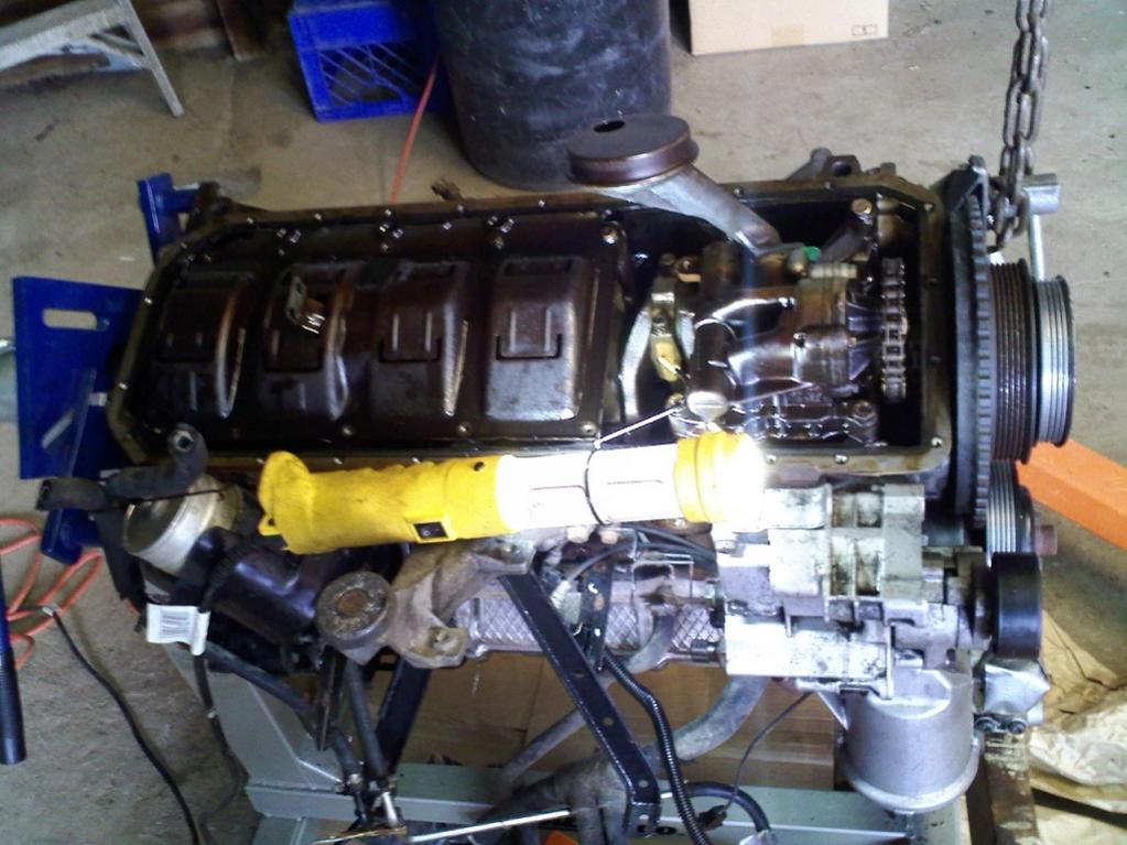

        More dismantling
        I had more prep to do than usual because the engine was kind of a 'medium block'. The AC compressor bracket was cracked and the front AC pulley was bent a little, but I am deleting AC for now (maybe forever) so no big deal.
        The M50 looked pretty haggard when I got it back to Indiana so I sprayed two cans of degreaser on it and carefully hosed it down with a pressure washer. Painted the block, exhaust manifolds and valve cover black.
        Replaced most of the gaskets on the engine. Water pump replaced with the metal variety.

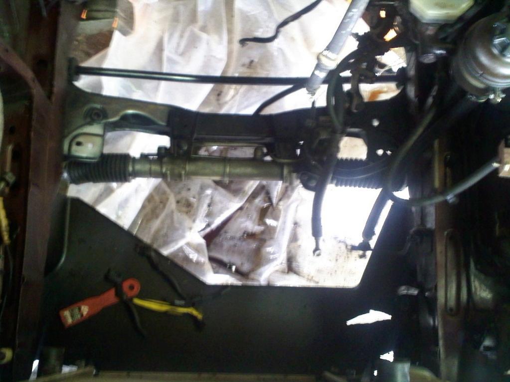

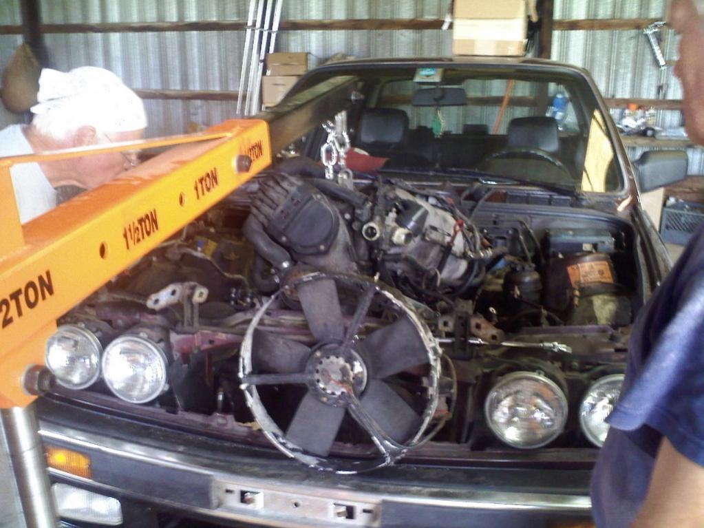

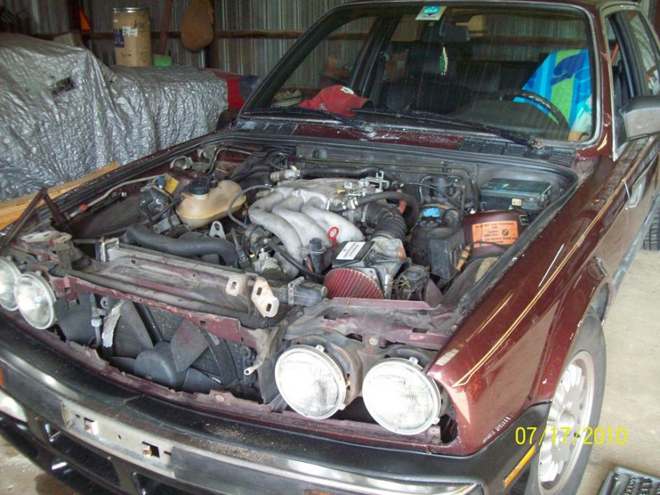

          Empty engine bay finally
          Had a lot of trouble getting the M20 engine out. The tranny was getting snagged on the swaybar and the shifter was not letting the tranny move forward. My seasoned mechanic friend wanted to drop the swaybar and front subframe down so we could get the engine/tranny out. I decided to take the shifter off and I jacked up the rear of the tranny slightly as he raised the boom on the hoist and the engine lifted out.

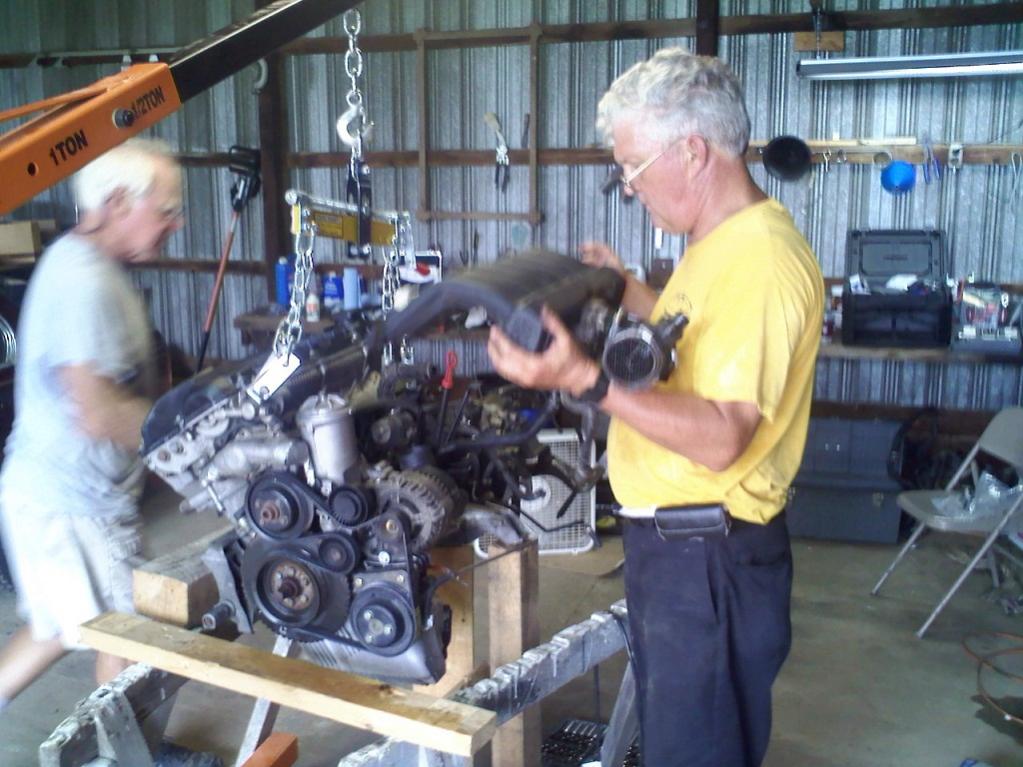

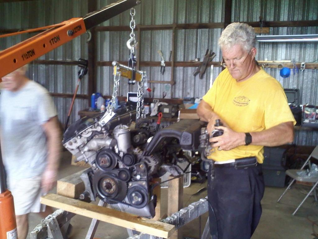

            Gearheads
            The tall dude in yellow is my elder mechanic friend Garry. He is an oldskool Mad scientist gearhead and has been a great aid in my first M50 swap.
            I owe him Bigtime for his assistance.

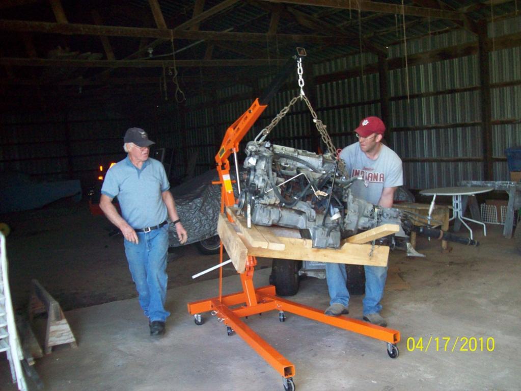

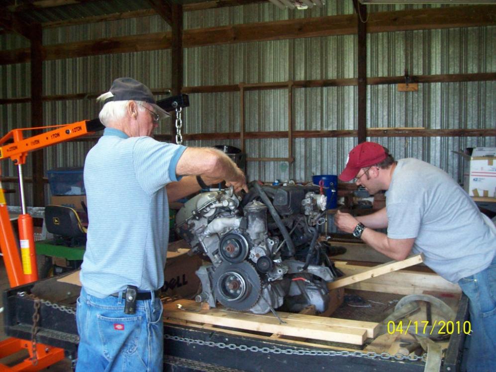

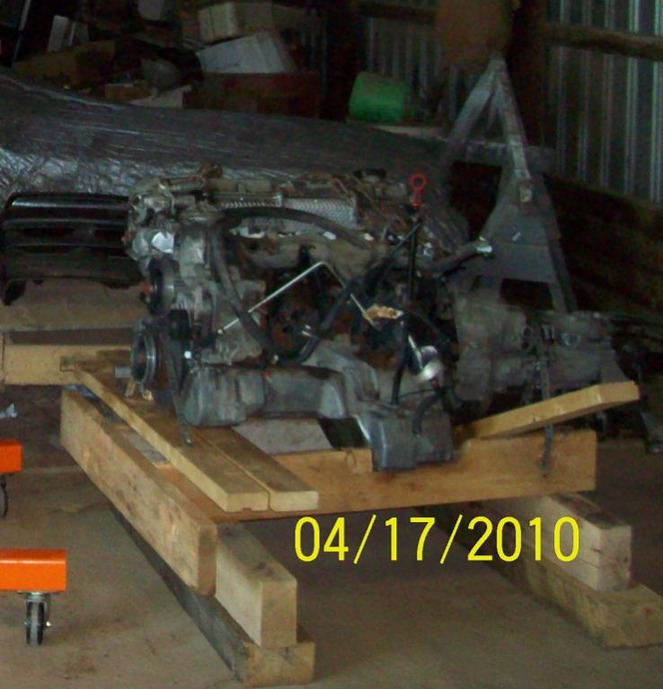

              Carpentry and schizz
              My Dad is the carpenter of the family and I am the Gearhead mechanic.
              He built this badass skidcrate for transporting the engine/tranny back from MI. His woodworking skillz have been helping tremendously in supporting the engine through the various stages of prep.

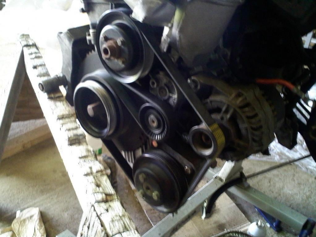

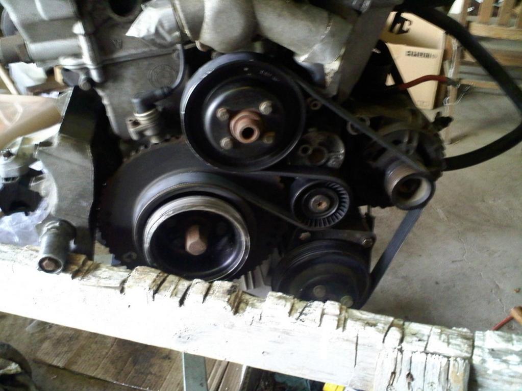

                  AC delete
                  The AC pulley bolts to the front of the crankshaft pulley and so the belt for the AC is separate from the main (alternator-waterpump-pwr steering) serpentine belt. If you are going to delete AC you just take off that little pulley on front of the crank pulley and then only run the regular serpentine belt.
                  Hope that makes sense..tired as hell from working on the E30 all day. :)
                  Attached some pics to illustrate

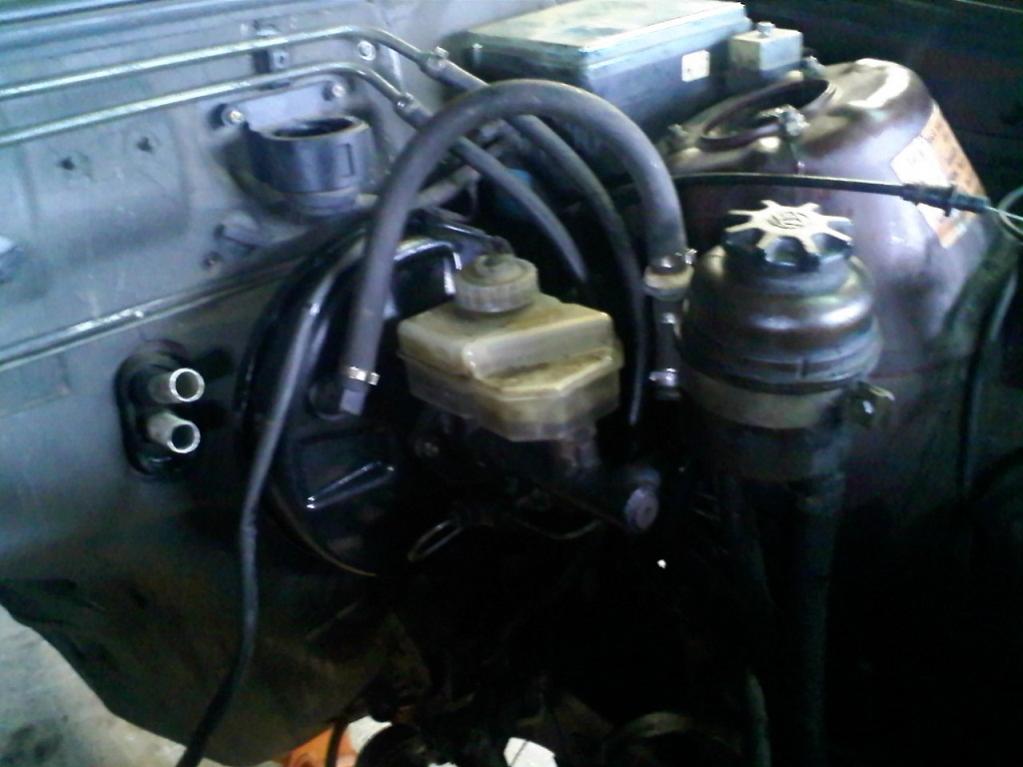

                      Brake bleeding question

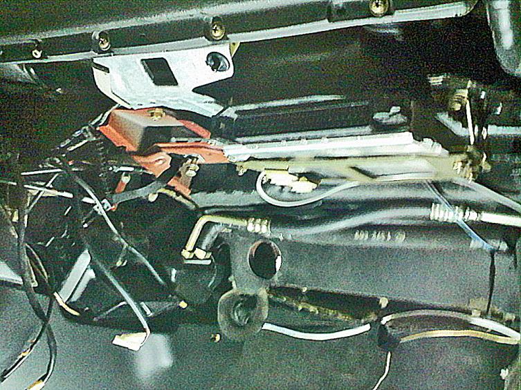

                      Ok is it necessary to bleed the brakes when you change from the stock E30 brake booster to the modded E21 BB? I was able to just take the two lines on the MC loose and pull the MC forward in car enough to get the new E21 BB into the car with just spilling a tiny little bit of brake fluid. Everything is hooked back up and brake pedal feels good. Is it necessary to just bleed the MC or do I need to bleed all four wheels as well? That is one thing I was never sure on before I started the swap. I have the Pelican parts power brake bleeder and blue ATE dot 4 fluid because I was set to bleed all of the systems.
                      Thx.

                      • z31maniac
                        • 17566
                        If you've cracked open any of the lines, you'll need to bleed the brakes.
                        But if it's been awhile, it wouldn't be a bad idea to just go ahead and flush the entire brake/clutch system while you are doing the swap.

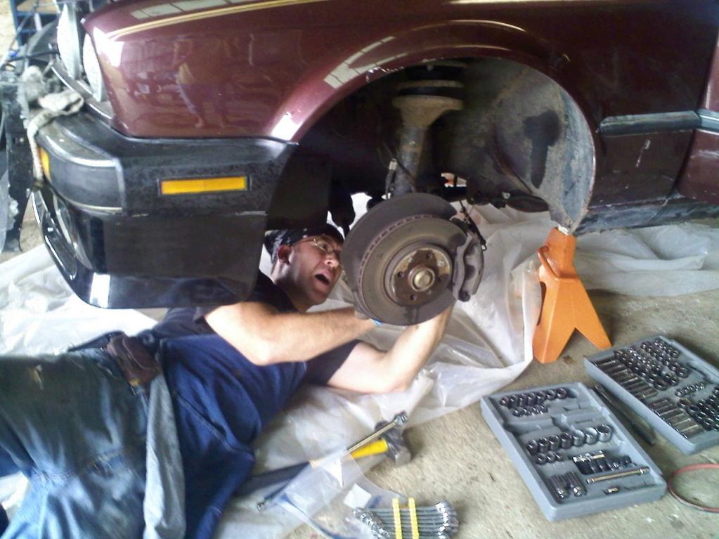

                          Engine bay cleanup and control arm removal
                          Had a very productive day on the E30 project.

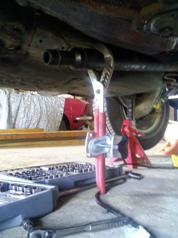

                          Cleaned out the engine bay with degreaser and foaming cleaner=huge improvement. Also removed both control arms in anticipation for the new ones coming this week. One control arm came off easily, but the other one was quite stubborn had to bang it out with Thor's hammer (My mini handheld sledgehammer) Cleaned and painted the transmission mount brace and that other S-shaped brace. Tomorrow I have to hit the hardware stores and find some missing hosery and also missing most of the nuts that connect the wires on the starter and alternator. :p

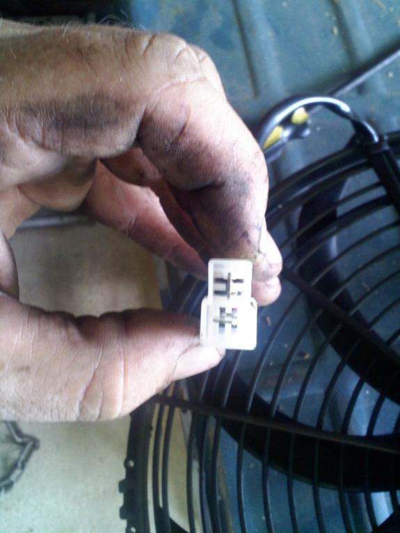

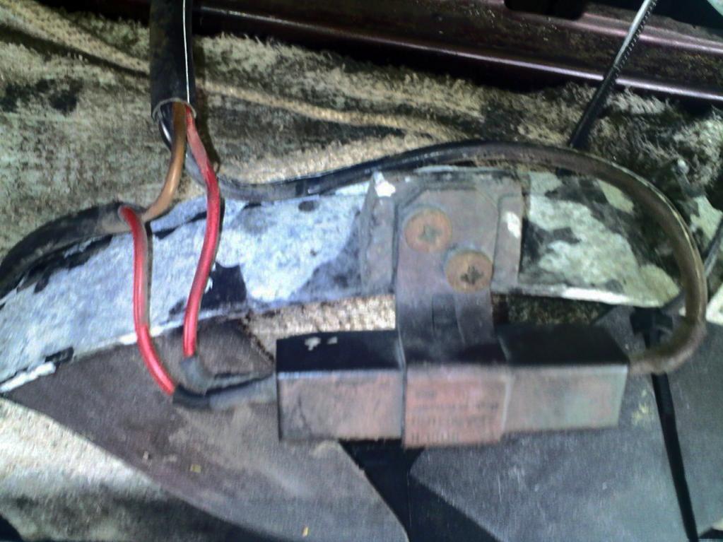

                            Most of my planning and research at the moment is on the radiator and electric cooling fan. I have a used late model M42 radiator I got on R3V, everything looks great on it except the plastic threads where the temp sensor goes in aren't in very good shape so that's going to take some TLC and ingenuity.
                            I bought a SPAL 14 inch pusher fan to go in front of the radiator (took the AC stuff out). I have been unable to acquire Stock AC fan wiring from a late model 318 which would make dressing up the cabling to the other side of the radiator much easier :(
                            I guess that's my biggest hurdle at the moment is I don't quite understand yet how to wire up the new SPAL fan to the stock AC wiring. On the AC fan there are two red wires so not sure where the ground goes into it. The whole being red/green colorblind thing isn't helping me much either :???:
                            Any help on fan wiring would be supremely appreciated.

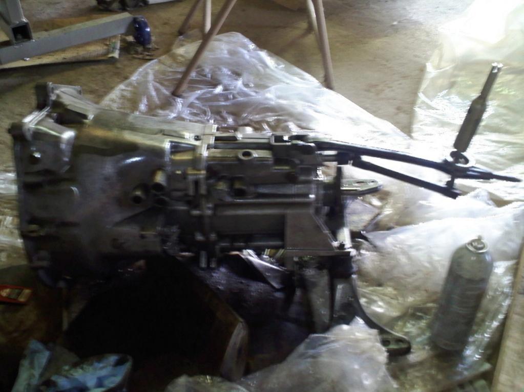

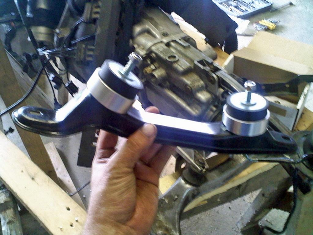

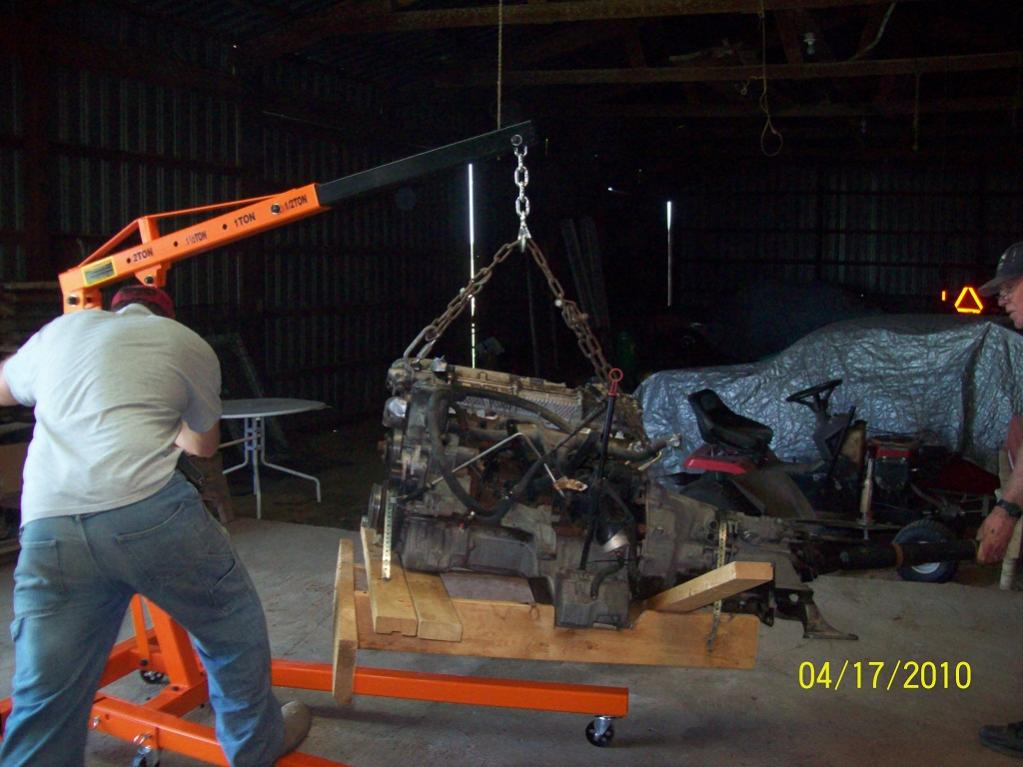

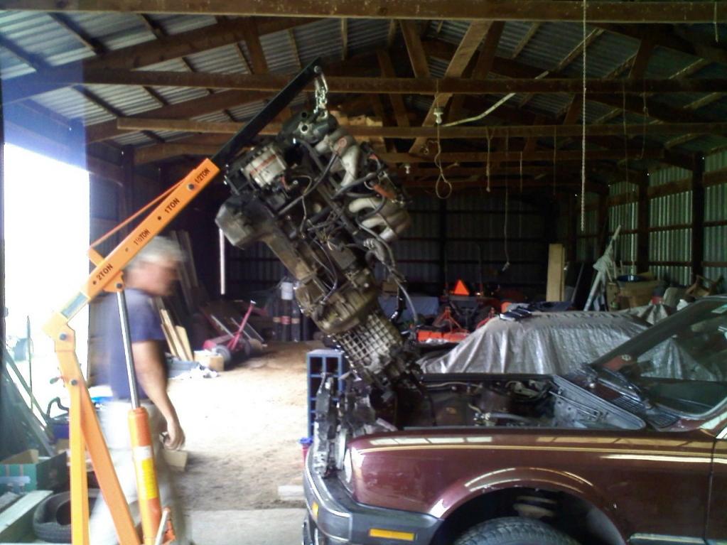

                              Videos of M50 engine install
                              We took some iphone video/pics of the M50/Getrag 250 install today.
                              Replaced both front control arms this morning. Had to shave some paint and a little metal off the control arm back rod in order to get the new Ebay rubber bushings to slid onto the arm. Used dish soap on the rubbers in order to get it to slide on.
                              Got the engine and tranny bolted in and also got the shifter linkage installed as well. Still have to find a manual E36 driveshaft and an E36 o2 sensor, but I was very happy to get the engine/tranny physically mounted into the car.
                              It went ALOT smoother than I thought it would, but I had three other dudes helping so that made a huge difference.
                              I also got the radiator and SPAL fan installed, but they are not wired/hooked up as of yet.
                              Exciting stuffs!!! :-D
