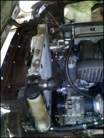

 I also wired up the new 14 inch SPAL electric fan to the Stock AC fan wiring and extended the plug over the the passenger side of M42 radiator so it can connect to the new 80/88 C temp sensor in radiator. It works great.
