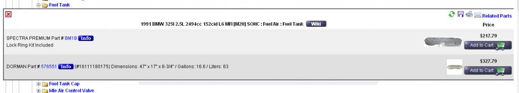

                            • dude8383
                              • Jan 2005
                              • 10387
                              Originally posted by M-technik-3
                              Rather due a new tank then por 15 the sucker.
                              Thats exactly the feeling that I have...I'm not 100% on these cleaning/sealer kits.
                              Factory OEM tank is friggin $630 while Rockauto has em for like $220-330.
