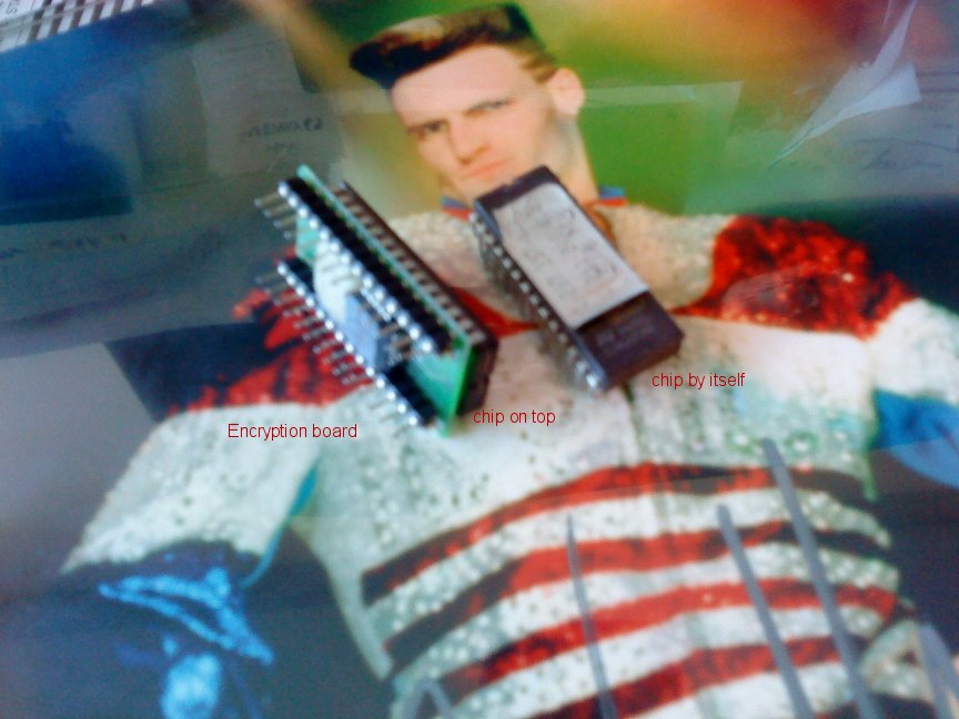

    I am 99% certain that it doesn't. I've been going back and forth with the maker of the chip that came in my car (Chuck Stickley). I sent him a number of pictures to answer this, but apparently he still can't tell. I'm getting frustrated. Can anyone here confirm that all I have is a chip stuck into the board without any 'encryption board'?
    See pics here:
    Backround- chip was sent out to previous owner who submitted the information about the mods the car had and got the chip that way. There are definitely some anomalies in the power delivery, and the engine will actually damn near stall if you give it too much gas at low rpms, so it needs to be remapped. I went to a dyno and got the readings necessary to make a custom map for it, but I'm getting frustrated now because Chuck seems apprehensive about whether or not there is an encryption board.

          Its a 413. No encryption board.

              both possibilities illustrated
              Once you have seen an encryption board, it is pretty obvious. So here is a pic to help you.

                Sooo why would there be an encryption board in the DME?

                  Wow- thanks for the pics Hellabad. That pretty much seals the deal- there isn't a green circuit board between the chip and the main board on mine.
                        That little tiny chip under the encryption board is like a "secret decoder ring" for hexadecimal.
                        When somebody figures out all of the addresses on the chip, for timing, mixture etc, and makes changes to the code on the chip, the encryption board keeps the guys on BF.c from using a chip reader to steal the code and have another group buy.
