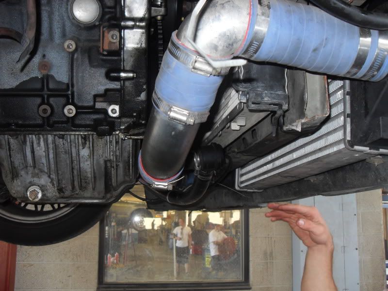

                        Originally posted by E30FTW
                        Are you using AA's stage 2 front mount and the associated piping like I am? Because I don't see any way in hell you made all that work without cutting it all up. Yours looks like a non-intercooled stage 1 as far as I can see, and if so.. yeah I can see those pipes working.
                        Damn, you are gonna slaughter my word like that?
                        Maybe I simply put the car together better than you.
                        Intercooler proof is here.
                        Or how about this
                        Please dont cut apart what I say, when in all actuality, I have touched and built my car, and you have simply heard about it on the internet.

                          Yeah, don't see why you are getting all defensive. That's not AA's front mount intercooler, it looks like some OE Saab unit, and neither is all that piping doing to/from it. A bunch of off bits of elbows and silicone couplers cobbled together that look like excessive failure points.
                          Here is a complete AA Stage II C38 Rotrex kit, with the piping as supplied from AA.
                          I'm not trying to start a fight with you, but seriously? Your car honestly looks very thrown together. I sincerely don't think you know who you are talking to, but that's just fine... The whole point I was making for the original poster was that most of the AA supplied piping for use on a e36 would not work on a e30. Not who's installation is cleaner and better put together.

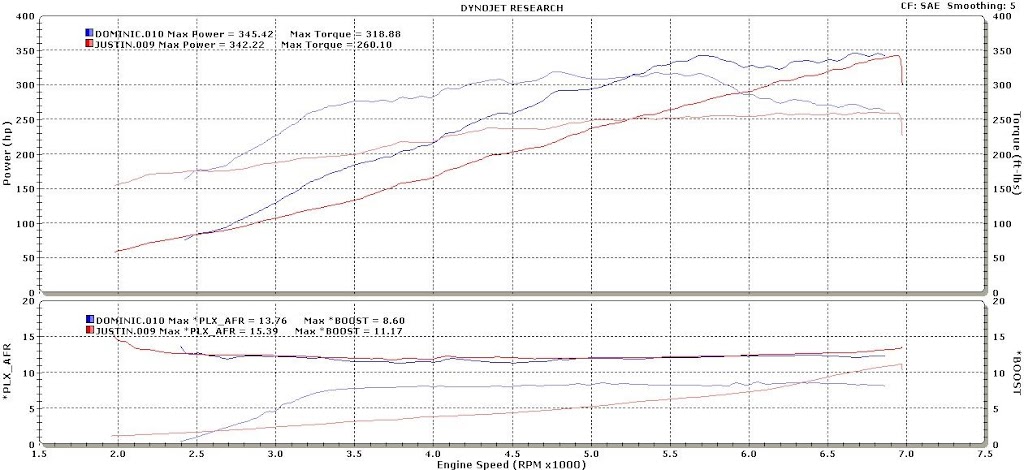

                          • Dominic49
                            • Feb 2007
                            • 1373
                            Originally posted by matt
                            Supercharging is a tease. Go turbo.
                            Grab a manifold from Blunt. I have turbos, BOVs, wastegates, etc. Then I can send a plug and play tune for up to 600whp.
                            true story...
                            why blow when you can boost...
                            m52 with s50 cams 11psi
                            vs
                            stock s50 8.5psi
                            • Adrian_Visser
                              • Jun 2006
                              • 2823
                              so an extra 2.5psi almost levels the field for hp but not torque eh? Jeez considering the difference in price between the two motors that is kind of humbling. I think the power bug has bitten me I want to turbo or S/C the s52 as as soon as I can afford it.
