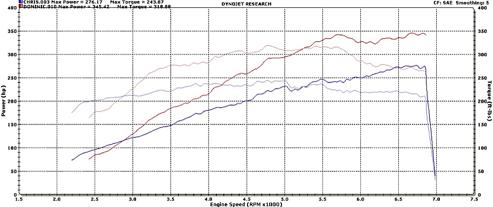

      Originally posted by Adrian_Visser
      so an extra 2.5psi almost levels the field for hp but not torque eh? Jeez considering the difference in price between the two motors that is kind of humbling. I think the power bug has bitten me I want to turbo or S/C the s52 as as soon as I can afford it.
      its not just the s50 vs m52. here is another one:
      active stage 1 c38 7ps e36M3
      vs
      my 8.5psi TRM S50.

        Originally posted by Dominic49
        true story...
        why blow when you can boost...
        m52 with s50 cams 11psi
        vs
        stock s50 8.5psi
        Why isn't the m52 reaching the claimed 11 psi until redline when the s50 hits 8.5psi around 3.3k RPM's? Me thinks that if the m52 was making 11 psi around the same RPM level, the comparison would look a little different...
          and thats just the comparison being made... supercharger vs turbo
            That's not how centrifugal superchargers work. They build boost based off of the crankshaft pulley. The engine can't spin the blower fast enough to build that much boost until you get higher into the rev-band.
            A positive displacement blower like a twinscrew, builds more boost almost instantly, which is why they are the preferred choice. Too bad AA's twinscrew kit is like $9k!
            For those that are power hungry, go turbo. A supercharger will never be able to keep up. However, a supercharged 24v e30 will be able to control the power much better than a turbo one. The crazy amounts of torque that turbo 24v engines make, cause serious traction issues, compared to a higher strung blower.
