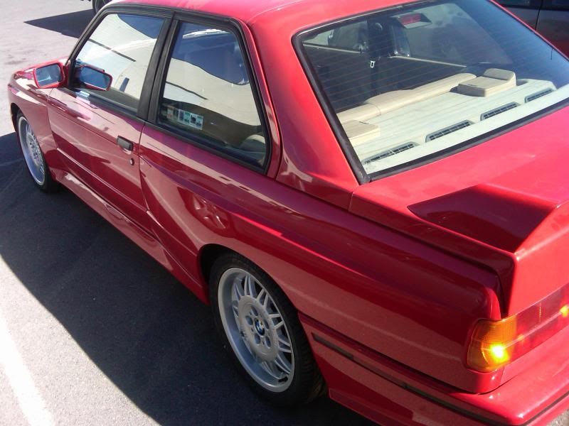

            Tomorrow is the day....

            • Uber E30
              • 1409
              Woah you need some spacers!
              -Alex
              • Lakis
                • Mar 2007
                • 160
                I did 15mm in the back and 17.5 in the front.......
                Once you open em' can't return em-
                I am new at this. Honestly though looking at the clearance I am very close; especially the front at full turn.
                Oh well. I am psyched either way. I haven't driven the car in three years. I've had it for almost 12.
