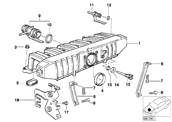

    Hey fellas, I was wondering if anyone could post a pic of where they bolted the dipstick in place. I am sure I am missing a bracket to bolt the dipstick in place. I have an obd1 s52 conversion with m50 manifold in my e30. Right now the dipstick tube is just inserted in the oil pan but not bolted to anything to keep it from moving around. Any close up pics would be appreciated. Thank you in advance.

    Use an e34 front manifold bracket, should have a place on it for the dipstick to bolt to.

                Are you guys sure you are using #16 (11611738165) from an M50 E34? It bolts to the front intake manifold bracket (#5) and it definitely fits.
                However, I can tell you it does NOT fit wit the Turner/Eurosport M50 manifold swap kit.
                '91 318is - OBD-II S52 swapped - E30 M3 5-lug - 5x120 BBS RC090 (E39 Style 5) - TCK D/A coilovers 550/700 [SOLD]

                  Ya, part number 16 bolts up to the front manifold bracket and then the dipstick ube bolts to number 16.
