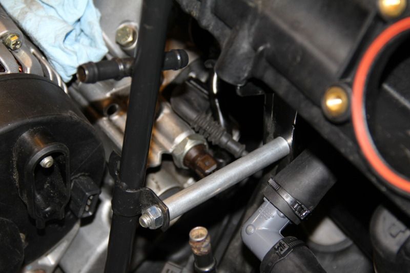

    Okay, I figured out the confusion. There are two types of dipstick tubes. The first one has only one mounting point. #16 works with this tube only and bolts to the forward intake manifold support as most people are aware.
    The second type has two mounting points like shown in the picture I quoted below. This one uses a totally different bracket that bolts to the block on one side and the filter housing on the other (IIRC). It has no other purpose than to support the dipstick (unlike #16). If you have a dipstick with two mounting points like in the picture below, you need 11431735535.
    Originally posted by BBDirtbiking
    I used all thread and an aluminum tube to attach it to the intake support.
    This is an M52 with M50 manifold and OBD1 conversion, just to clarify.

    • BBDirtbiking
      • Apr 2012
      • 323
      The way I have it above is plenty sturdy for my tastes.
              This is how I ended up doing mine. S52 with stock M52/S52 manifold); Thank you for the idea ^^^
              I did try using bracket #16 as shown on realoem (aka 'hose clamp' lol) and just could not get it to line up with anything. I finally found this picture of how its supposed to mount and I guess you need the M50/E34 specific manifold bracket??
              Figured I'd post this here for anyone else confused about that bracket.​
