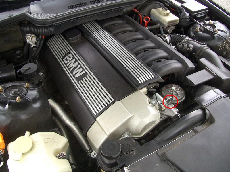

bump,i just got the intake manifold off and electrical all disconnected and labeled but i cant see where you hook up an eyelet or bolt to the front of the head. Does anybody have a picture or specific location? all thats in that area is valve cover bolts and what appears to be the vanos sensor...which dont look like they would hold the weight...i did find the bracket and hole near the starter so thats all set.Comment
