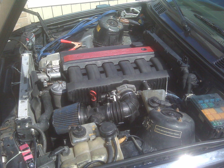

                            well unless you have done it yourself, i see where you're coming from on thinking its not possible. i can put a fan on just by twirling it counter clockwise. done. i can do that easy with the engine in or out the car. :)
                            and the selector rod. you dont need anything custom, nor do you need heat. put one end into the ring of a wrench and the other end into another wrench. twist and done. my shifter sits as if its stock position.
                            theres my setup. stock throttle cable untinkered, and stock m20 fan.
                              I like your approach for the shift selector rod. I shortened the one in my friend's car, used the Getrag and made custom trans x-member.
                              Also used the stock TB cable.
