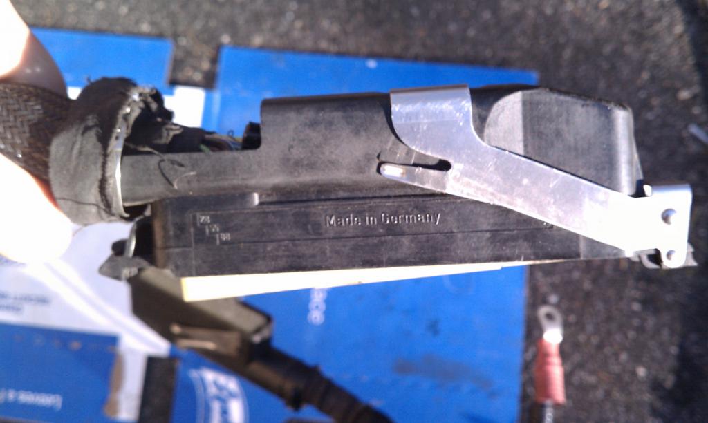

        I have pictures for reference. Picture 1 (o) shows the Old connector that was on my old car that fits.

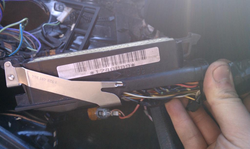

        Picture 2 shows the new harness I got. Look how it is offset on one side. I was told it was from a '93 Vanos Auto.

          Those connectors are both halfway disassembled, that may be why they don't fit.
            Is the new harness supposed to be offset to one side like that? Or is it stuck?

              It's disassembled. That's not how it fits together. I don't know if it's stuck or not.
                I figured it out. It wasn't aligned properly, I was able to pull it out and seat it correctly lol.
