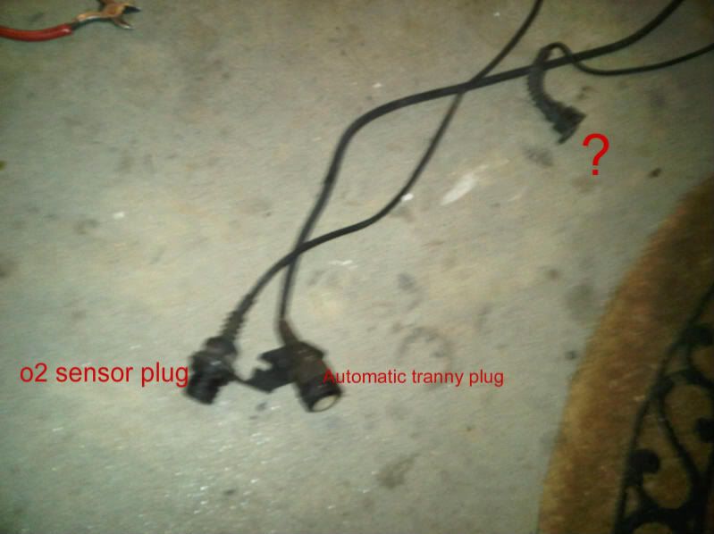

            Ok, I found the wire that I cut, and here is the o2 sensor wire. I am now wondering what this square plug is? It is 2 pin. they were all bundled up together. Is it the reverse sensor? REMEMBER, this is from an AUTOMATIC.

              I'm thinking it's probably not for reverse, since that would have to go on the switch that goes in the trans. I would just check an ETM, possibly on the auto trans pages.
              • matt
                • 3731
                Yes, that is for the reverse sensor.
                • nando
                  • 34827
                  always verify by wire color before cutting stuff off..

                    In the swapped e30, we connect the reverse sensor from the body, not the engine wire harness like on the e36. Correct?
                    Winner winner chicken dinner?
                    My Seller Feedback Thread
                    • nando
                      • 34827
                      yes
