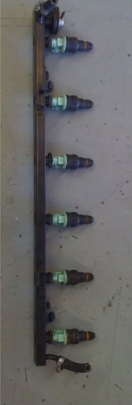

          Well yes, Thank you Adrain for your help. Moreover, I went to force life in her today and she fired only for about 20 seconds and died. I have had a hard time getting her to idle. I checked for fuel and she gets fuel to the rail, but it seams like I am not getting fuel, got spark, but no fuel to burn? could this running losses valve have anything to do with this? I also had a lose vacuum hose that should go from the manifold to the fpr; unknown to me I could not find the fpr off the fuel rail. FPR MIA! I feel like I have a can of worms.

            More than likely you have the wrong fuel rail. There was an m50 that didn't have the fpr on the rail. Not sure which one. But you need the fuel rail that has the fpr on the rail. Will be a place on the fpr that a vacuum line will hook up to the manifold.
              WTF! So Samiam your telling me that I have to get an other fuel rail? Show how did this system regulate psi in the first place? This is good info thanks; this still does not explain why my injectors fail to open. I have a bad feeling that they are not getting grounded. As I get deeper into this swap I find all type of bad news. :letitout:

                It should look like this. Does it?

                  negative, my fuel rail does not have the fpr at the return side. Adrian poseted that the plug I asked eariler was for a runining loss valve; I looked it up and controles the fuel from staying in the fuel rail too long to prevent the fuel from heating up? Do you think that this is where the vacuum line plugs into? Im lost. I tried starting her today and she stills does that same thing, fired up for a second or two then died blimping it did nothing. I am greatful for the help.

                    negative, my fuel rail does not have the fpr at the return side. You need one. Easy fix.. There will be a hose that goes from the FPR to under the Manifold by the Air temp sensor.
                    Do you think that this is where the vacuum line plugs into? Im lost. Charcoal canister has two lines one that runs down by the fuel lines, the other goes to a valve that goes to the TB. That connector you were showing goes to that valve.
                    Sounds as if you have vacuum leaks all over the place. Going to be hard to get this thing even close to running right with out the correct fuel rail and the vacuum hoses ran right. Surprised you even got it to start at all really.
                    At least there are some known issues that are slowing you down. At least your not at a complete loss as to whats wrong.

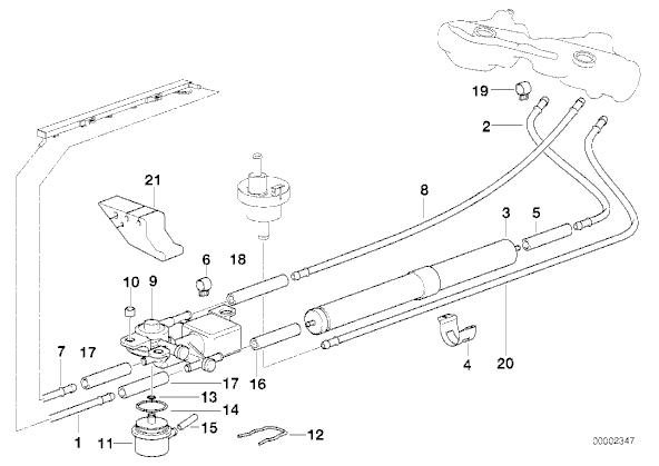

                      check this out

                        11. is the fpr. could this be the chingus that gets connected to the runining loss crap?
                        should I scrap this and get the fuel rail with the fpr on it?

                                First if your Fuel rail doesnt look like the one in the pic above start with that. The Run loss crap is for a diff car. You need to focus on what works for these swaps you will spend more time on trying to make something work that just doesnt work then getting the right parts.
                                The E30 setup uses that vacuum reg. FPR to regulate the amount of fuel pressure in the rail. Without the corect pressure your injectors will not fire right the computer will recognize a problem and is probly shuting the car down or just dying all together.
                                Find the right fuel rail, hook up the vac line to it. Leave that sensor unpluged for now make sure you have a 413 red lable DME works the best with no issues. Try that an let us know.
