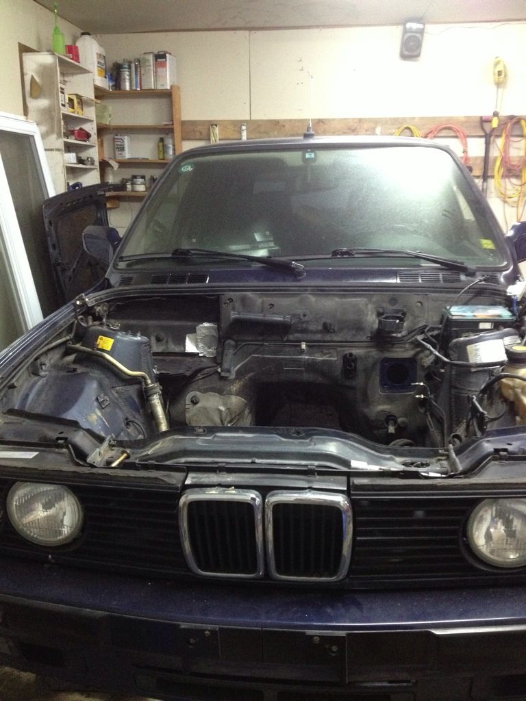

                                Update
                                Ok, so the second shop that was going to do the swap didn't have time, but they put me onto a guy they know who was looking for a neat project to work on. He is a really knowledgable guy and he is doing the swap for me as we speak.
                                He has extracted the e30 engine and is prepping the s50. You should see the 1970's dodge he built. So clean.
                                The ecu and harness are on the way back from Dave markert. Starting to come together!
                                As it sits:
