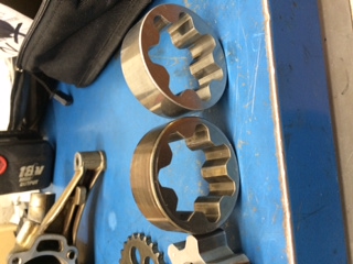

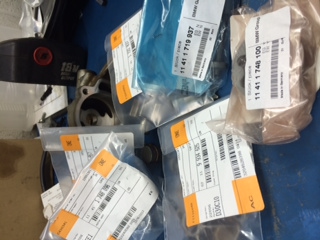

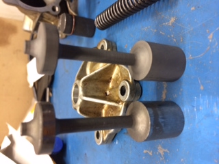

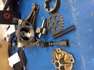

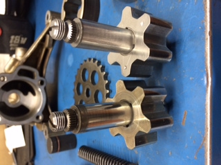

                              A little oil pump rebuild all new original BMW parts.
