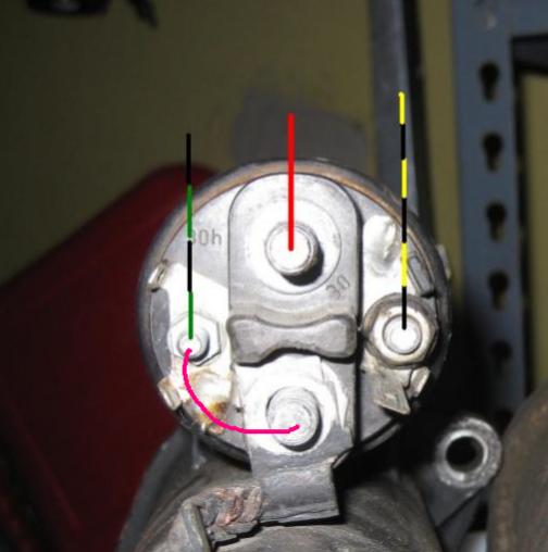

                          First off, check relays, maybe fuses, but most importantly, relays.
                          If relays test good:
                          1. Make a jumper wire with some male spade terminals on each end.
                          2. Remove K5 (windows) or K7 relay (blower motor controls)
                          3. Plug the ends into the slots where relay terminals 30 and 87 would go (look underneath the relay for reference.
                          4. This will power up either windows/heat without having the key turned in ignition.
                          If still not working, go back to the ground issue.
                          1. Unplug engine harness at c101.
                          2. Test continuity between your c101, pin 15 (body side) and terminal 85 in relay socket (either k5 or k7)
                          if checks out ok:
                          1. Plug c101 back into engine harness
                          2. Test continuity from terminal 30h on starter (smallest lug) to terminal 85 in relay socket
                          if checks out ok, your starter isn't grounding internally.
                          1. Run an external wire, about the same gauge at the wire at 30h from terminal 30h on the starter (smallest) to the larger lug that has the braided ground wire.
                          See attachment (pink line)
                          Hope this helps, i went through the same thing because my starter wasn't grounding correctly internally through 'new' rebuilt starters. My solution was to ground it externally like the picture, and still have the unloader functionality when starting the car.
