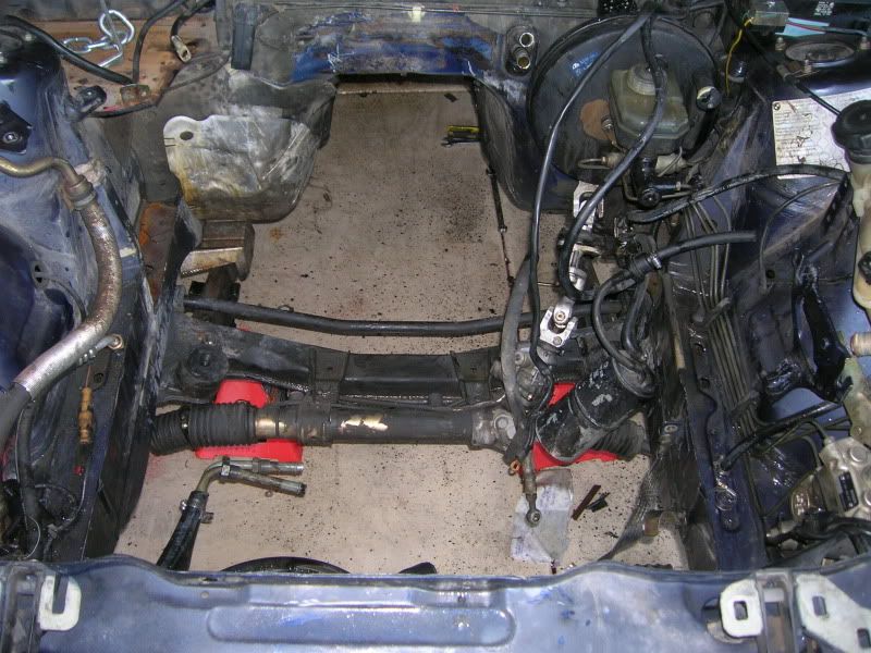

    after the way that the autotragic and M20 were leaking (more like marking territory) I planned on a degreaser party, both for the undercarriage and my garage floor. I have a puddle the size of a small lake where the engine and trans normally sit
    Now is the best time to get it done, it really does make a difference too.

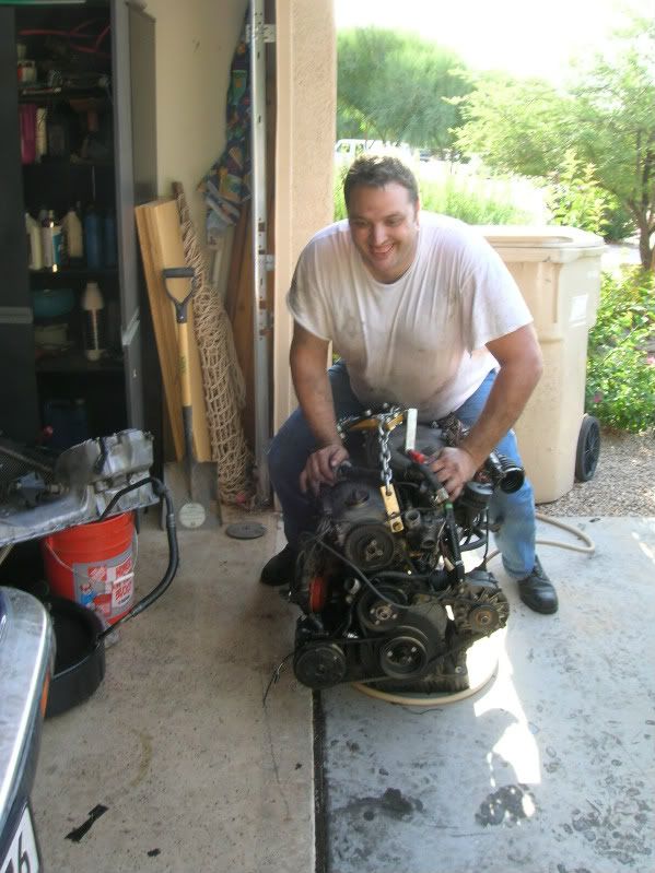

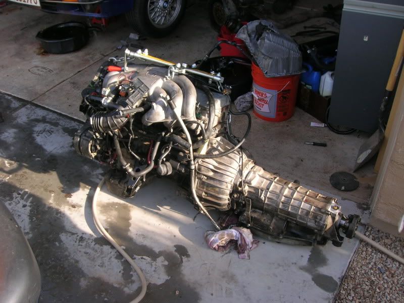

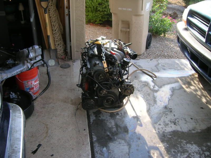

      today I started early, and the M20 is no more.
      heres a few shots of the action
      The Famous M20 Powered Trash Can
      Bye Bye M20, Bye Bye
      DIE PIECE OF SHIT DIE!!!!!!
      and some gratuitous motor dry humping for your viewing pleasure (or to make you gouge out your eyes....)

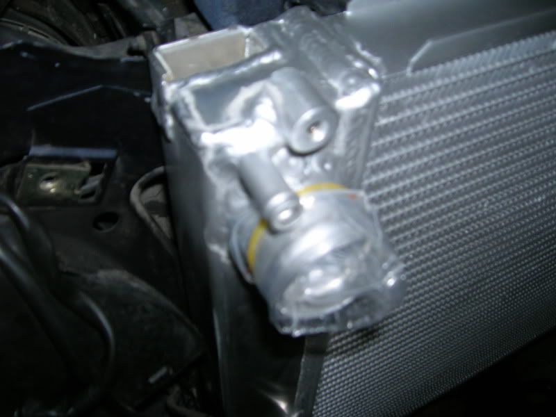

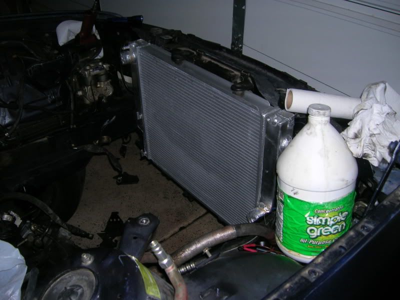

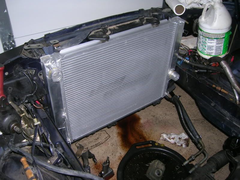

          got some of the parts in today, namely the new radiator. All aluminum, no plastic tanks. Dropped right in no issues. Appears to be decent build quality (knockoff of a Mishimoto??)

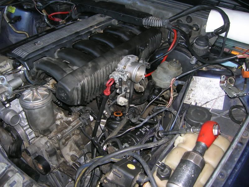

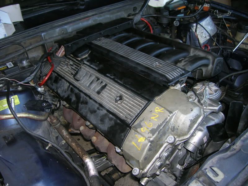

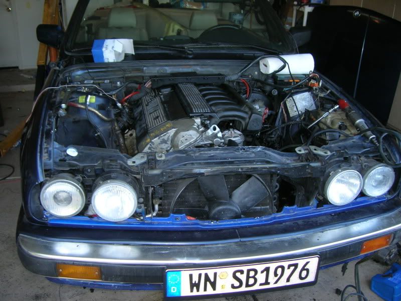

              IT IS IN
              At long last, the M50 is in place. Motor landed on its mounts as designed at about 1120 this morning. I took a few hours off out of the sun, and then decided to run the wiring harness. Here are a few pics.
              Still a bit to do underhood, such as mount the alternator, PS pump and radiator. Hoses need to be connected, and the fluids need to be topped off. Ebay headers will be here tomorrow, so I will start on the exhaust shortly, but for right now I have the stock manifolds open dumping should I get the desire to fire it up. I realise the wiring is a bit ugly right now, but that will be taken care of on payday (M3 covers hide lots of sins...) and the valve cover will be removed and painted soon. I will be most likely rebuilding the VANOS unit soon, and will do the valve cover at that time. no sense wasting a perfectly good gasket
              Transmission still needs the linkage connected, the slave bled and a mount manufactured. I have all the materials, what I lacked today was time and ambition. 115 degrees sucks to work in..... Guess Im just not a true enthusiast afterall.... (Ill do it at midnight instead)

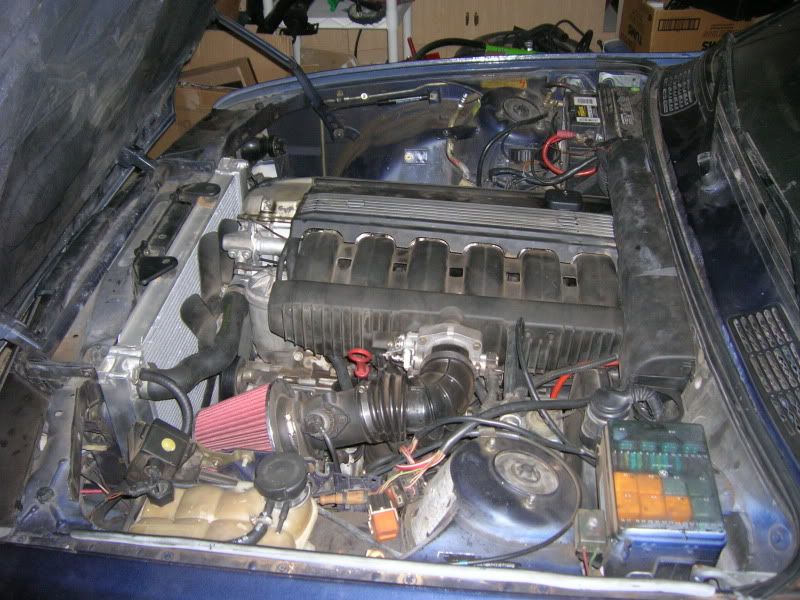

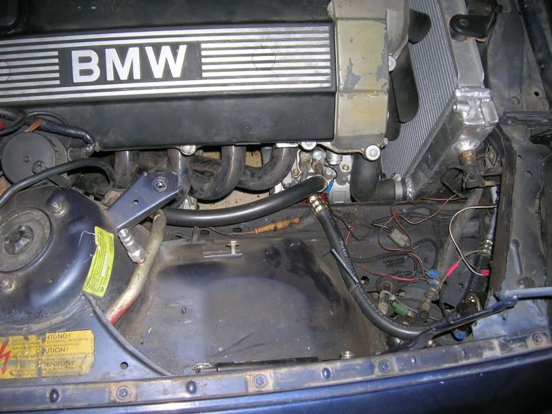

                        Figured I would post an update here, as it seems once the swap is done, all information stops.
                        Its been about 2 months and 3k miles on the swap since completion, and the car is performing admirably. LOADS better than the sick M20/Autotragic combo that was in the car to begin with.
                        Had some minor issues with hose clamps needing tightened again, and a few wiring niggles, such as the oil level sensor needing to be hooked up correctly, and the diagnostic connector needing a wire redone. other than that, the car has needed literally nothing done to it save adding a half quart of oil.
                        I finally got the M3 firewall covers. That cleans up the bay a LOT, however I need to track down the 318IC cover for behind the battery, as the M3 one doesnt fit right without a LOT of mods, due to the front mounted battery. I will most likely get another harness, and custom redo the leads for the three relays, and move the diagnostic connector to the drivers side where it belongs on the cover. I will probably also redo the C101 connector as part of the harness at that time as well, but these are things that will happen down the road.
                        Here are a few pics as she sits today:
                        Ac compressor installed with custom hybrid lines (e36 compressor fittings to E30 body side)
                        Rats nest at the battery that still needs some work....

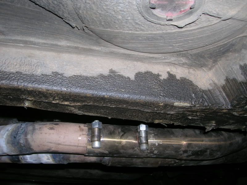

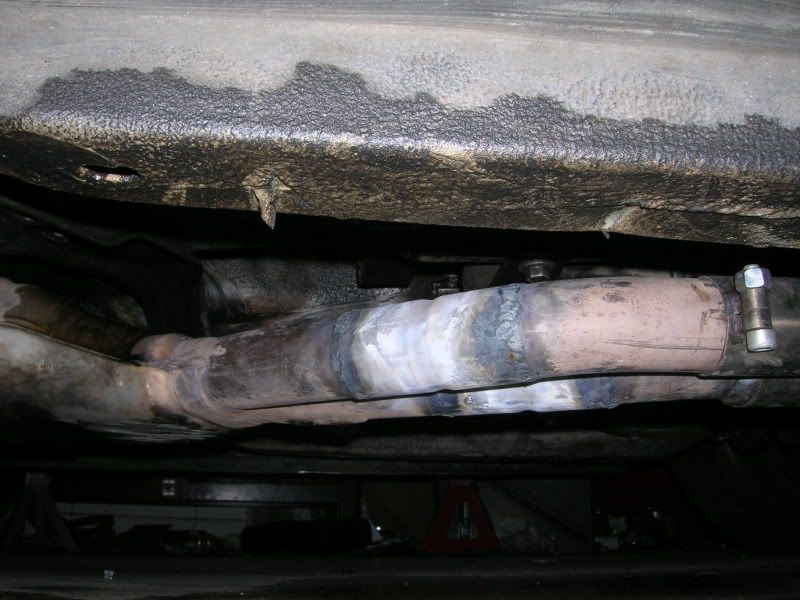

                        And finally the work done to the exhaust to make the original E30 cat connect to the Ebay headers. This system works surprisingly well, and even though I welded mild steel to the stainless, and therefore wont last forever, it does suit the purpose and fit the budget that I had at the time. when funds are available, it will get redone, but no rush on this. it works, sounds decent, and doesnt piss me off.....
