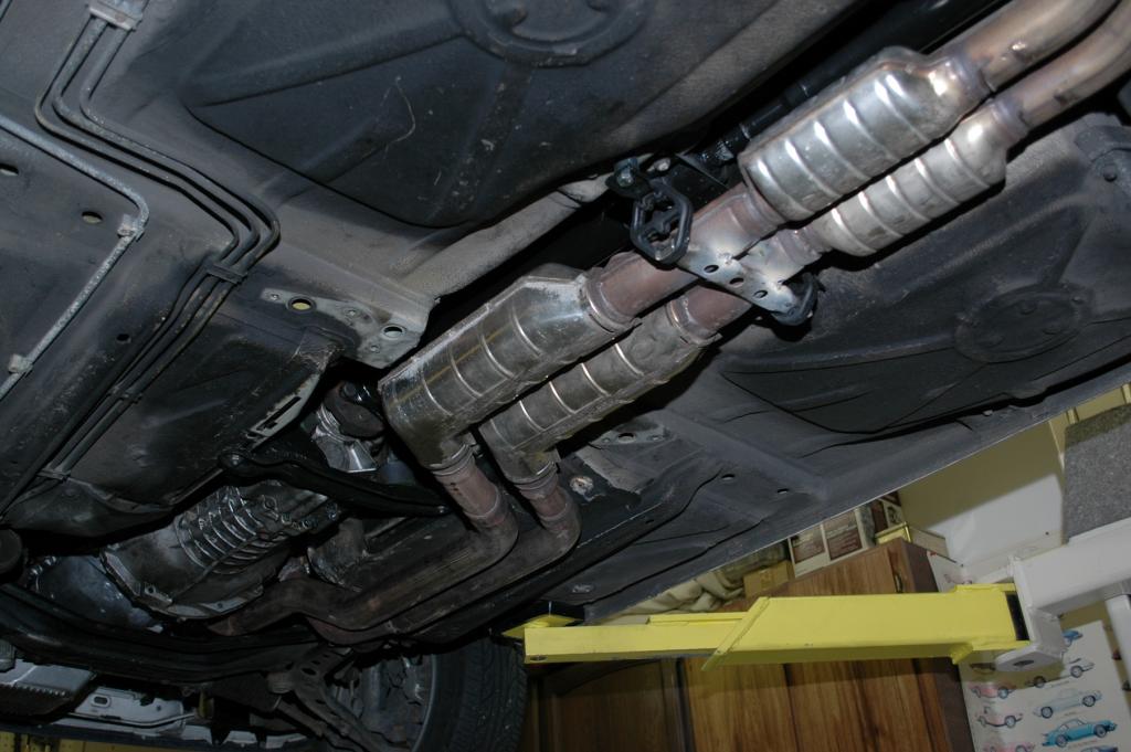

    e36 exhaust on 24v swapped e30
    Does the e36 midsection with cats bolt up or do I need to get cats welded in?
  • dude8383
    • Jan 2005
    • 10387
    Yes, you can use the whole system :)
    • lbreevesii
      • Aug 2009
      • 412
      hanger locations the same?

        It will hang pretty low.

          okay. I need obd1 cats and trying to figure out what to do
          • hoveringuy
            • Dec 2005
            • 2742
            It will fit just fine, sound great and pass emissions.
            Biggest downside is that it's heavy.
            I recommend the OBD2 cats because they have less restriction.
            • dinanm3atl
              • Feb 2007
              • 7305
              It will hang VERY low. Like it will hang down that it will drag on speed bumps while on E30 M3 springs.
              • rlddlr53
                • Oct 2009
                • 1450
                I need to pass carb
                • dude8383
                  • Jan 2005
                  • 10387
                  Agreed, mine does hang rather low. Contemplating a custom system... I like hoveringuy's mounting points though. That could really pull it in closer to the chassis in that section.
                  • dinanm3atl
                    • Feb 2007
                    • 7305
                    That is much better. It sure is tucked though and with the e36 downpipe on the midpipe not sure how that could be completely stock and be that far up in there.

                      Youll need THR CABs

                        Originally posted by 328ijunkie
                        Youll need THR CABs
                        I've never had them, never will. Everything fit fine with stock CABs once I did some slight modification to the down pipes.

                          "Slight" being some fun with a BFH?
                            No, did not use the 12lb clearance tool (this time). Used hacksaw to cut halfway into the pipe in strategic locations, bent the pipe slightly into the cut, Mig'd back together.
