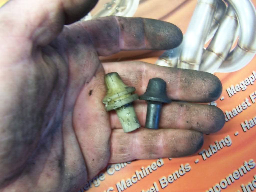

    Ok. Took both fork pivot pins out and measured the bell housing casting and they are the same from the g260 to ZF, but the pin is 1/4" longer...
    Also the slave installed on both, relaxed/open, the ZF slave is 5/16" closer to the diaphragm spring than the g260.
    ~1/4" doesn't seem like much, but when we are talking about ~1/2-5/8" total travel, it's a lot.
    Going to make an adjuster to get the pivot pin closer to the diaphragm and extend the slave rod, assemble it and see what happens.

      shouldnt take much to do. Make a custom pivot pin on a lathe, and maybe a threaded end on the slave cylinder for more adjustability.

        Drilled the trans to accept ZF pin and pulled the slave rod out and put in a longer one. :)

          that will do it... hopefully the plastic pin will hold up over time (I replaced mine when I installed it) seems like a shitty place to resort to plastics....
