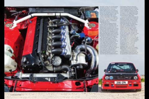

                      Seen this in Performance BMW
                      Ever heard of a rotrex making 20psi! and 700HP
