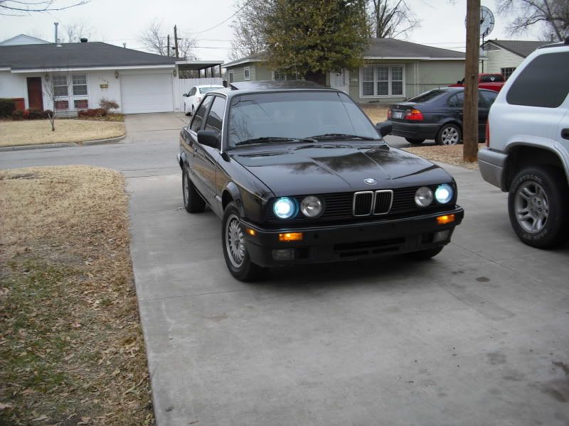

              MarkerMW is in ATL. I bought this E30 in Sav,GA last year and drove it back to Tulsa.
              Threw a set of 14" weaves and it sold for $5.5K
              I paid $450 at the auction for it and spent $600 going to get it lolz.
