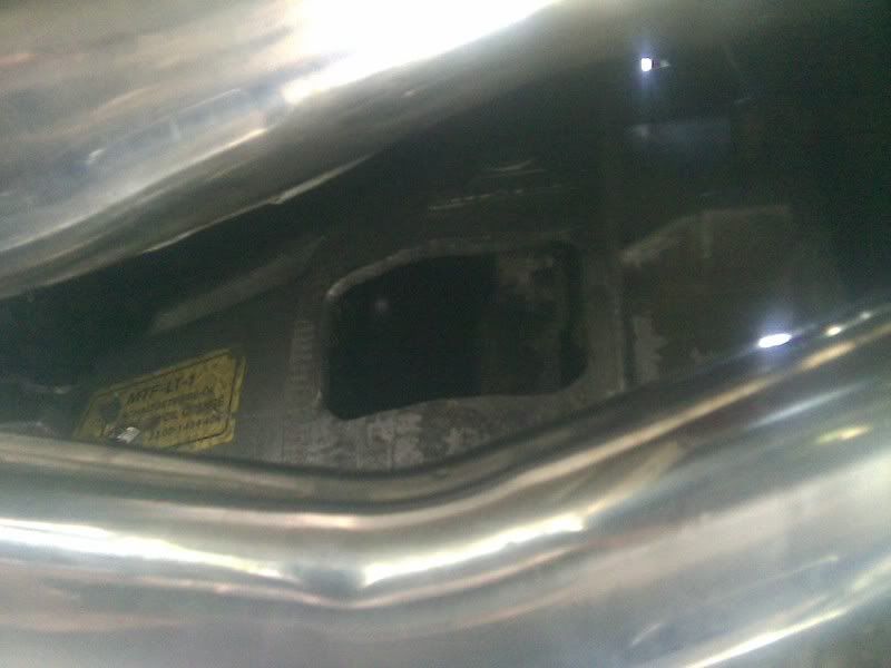

                      careful that you get all the pieces from the over extended slave cyl out of the bellhousing if they came apart. that happened to me and they shot out of the bellhousing and blew a huge hole
                      • Mr.SWISS
                        • Nov 2005
                        • 1251
                        You mean like this! :crazy:
