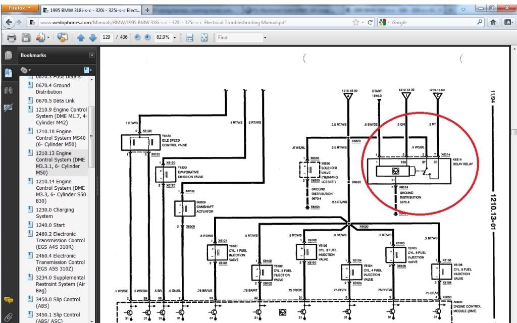

    Hey guys I'm swapping my buddies e36 obd2 m3 to obd1. I have a '95 harness which has the delay relay and the running losses solenoid valve. I've been doing some research but can't find the answer as to whether it is ok to leave the running losses solenoid connector unconnected to anything.
    It appears to be for the late model 95's that had the obd2 style fuel pressure regulator with the extra 3/2 valve on the side for bumping up the fuel pressure, am I correct in this?
    If anybody can help me find the answer to this question that would be great.
    Thanks,
    Michon

    did you ever find a solution to this? i have the same relay missing on my 95 m50tu swap

      You dont need it :D

          i know we figured that out over the phone when you unplugged it lol, but are there any consequences like CEL or anything?

            My shop manager is running basically your same harness with NO cels ;)!
