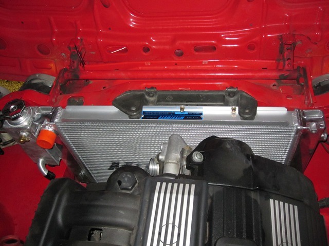

                  You could also go internal expansion tank like the m42 rad or what this guy did
                  E36m3 mishimoto with aluminum tank from m42 aftermarket rad shortened and welded on, think I'm going to try this one

                    I'd go for the m42 but I also want to do a fan delete and just don't want to risk having a rad that small in there. That looks so clean, I'd love to do something like that but I have no welding experience what so ever, but I think you should, that'll be one of the cleanest I've seen that's custom fab'd
