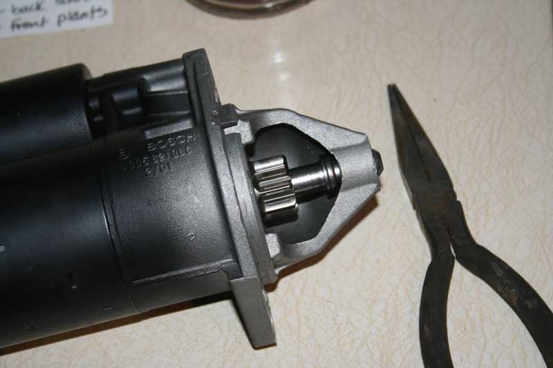

Sooo... I just swapped back to the 260 and am having some issues with my starter... its not making contact with the flywheel. It sits there and whines and whines... I'm assuming the starter clutch is dead?

It looks like the problem is that my flywheel is spaced too far into the tranny... The cog on the starter sits at the back of the starter- the rod that the cog sits on is plenty long- is the cog supposed to move back and forth on that rod?
edit: yes it is....
I've replaced the starter and still the same problem.Last edited by Addissimo; 10-14-2005, 02:48 PM.

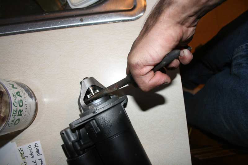

I hooked it up to a 12v source... The cog isnt being pushed out.
p2
p1 p3
p4
to post 1 i have the black/yellow wire attached
post 2 I have the black/green wire attached
Post 3 12v
Post 4 nothing.
Am I missing something?

Okay-
so i'm retarded... I got the cog to start extending- i was just trying to wire it like my e36 one... meh...
The problem now?
It doesnt seem like it has enough power to turn the engine over. I'm using a new battery and the voltage is plenty. When I try to turn it over, it lags the engine a bit, then stops turning the flywheel and just starts to click.
