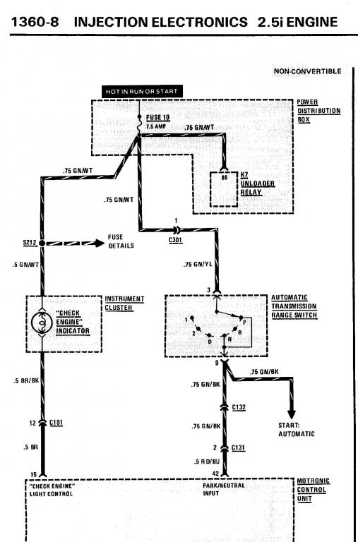

                        • mentaleeill
                          • 850
                          cel should be at pin 12 on the c101 according to the etm on wedophones. the diagram you showed, has the active check control highlighted, which should be for the overhead check panel, not cel.
                          • mentaleeill
                            • 850
                            as shown here
                            • SkorcherX
                              • Jun 2011
                              • 267
                              Originally posted by nando
                              have you tried any of the factory BMW scanners to see if they pull anything?
                              I have not. I would imagine I need to take it down to the dealership to have it scanned. Pretty curious what kind of looks I will get.
                              I just pulled back the C101 plug cover and confirmed that the Gray wire from the DME is pinned to #12. Just as the schematic shows in the pic mentaleeill posted.
