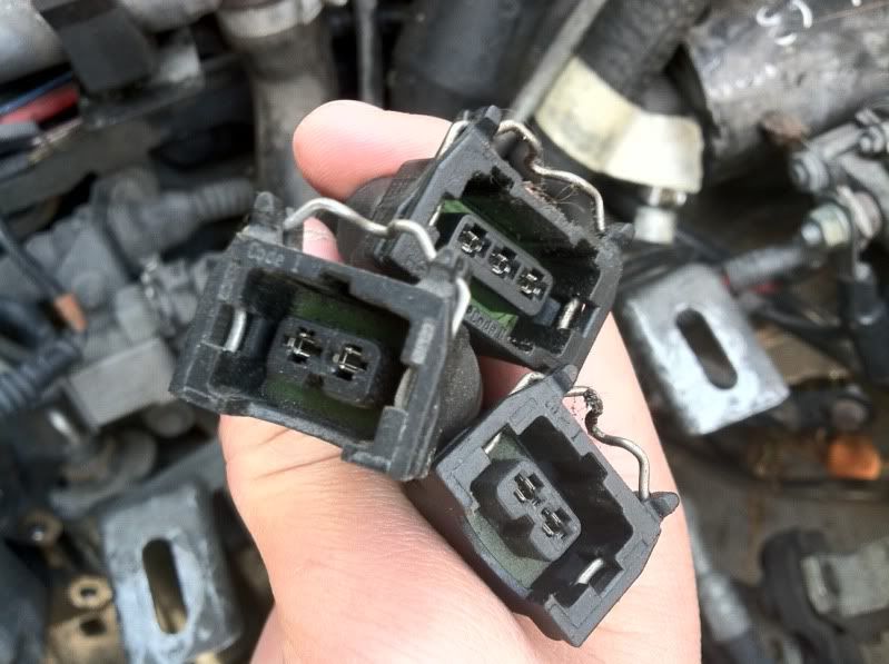

    Hey guys, I haven't posted in the longest time but I have been undergoing a S50B32 swap into my 91' 318iS but now am stuck on some problems.
    First off: My engine harness has two harness plugs, two ECU ports, and and seems like an excess of the usual wires and I was told that this is because possibly it came out of an SMG car. Has anyone read or experienced the same kind of issue?
    Second: I have three connectors that come from the starter area running towards the front. Both of the two pin connectors have Red/White & a Brown wire, then the one that is a three pin connector has Green/White, Grey/Brown, and Brown. Where do these go, do I need them, and/or what should I wire them to? Here is a picture to show what I mean:
    Thanks!

    Gonna guess EVAP, IAT (since your plenum isn't on), and oil level. You have the diagram for that engine?

      Oh ok cool, I forgot about the bottom of the plenum and i will check that out along with looking for the wiring diagram.
      You happen to know which is for oil, and which is for EVAC? 2pin or 3pin?

        Three pin one is for oil, two for the EVAP solenoid on the control arm
