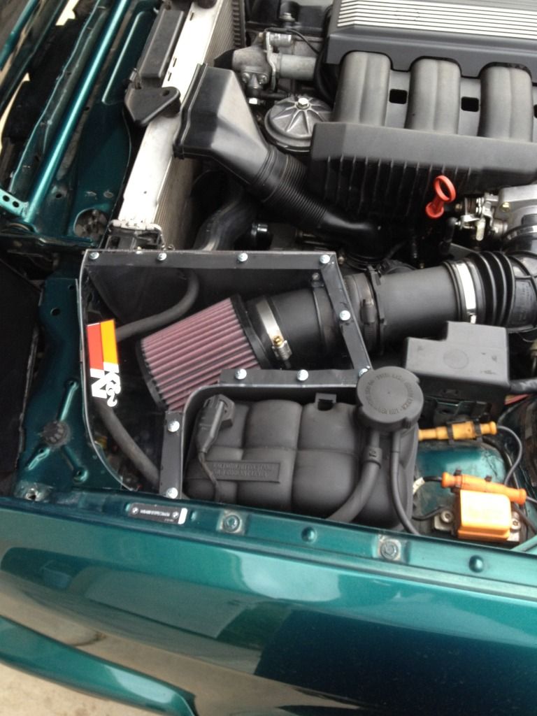

I'm hoping to start on the M52 swap for my touring over the coming weeks, I need to figure things out so I can get it all sorted before the shell gets a full respray. I have nothing to go on or get me started except a M50 intake and the AFM. I was hoping to run with the stock airbox but this gets in the way of the top rad hose. So I'll need a cone of some description and a heatshield also.
This is my 1st time using a cone, the obvious cone contender is a K&N filter but I'm sure there are others. What other filters are available and better if there are any for not to many dollars! I've been looking at Dave-F kits and found he used a RU-2590 K&N filter. If anyone has used this particulat one, does it fit in behind the lights? I've read it's best not to bolt the filters to the AFM directly, how much hose/pipe should be use or can be used?
For a heatshield I was going to make something that butts up against the under side of the bonnet with a rubber/foam gasket on the top edge. I then found out about Castros airbox which looks like a neat solution. Another option was to run the filter down through the little panel to above the brake ducts, or at least drill some additional holes for more air.
I need a intake elbow on the TB also, Turner does a nice one but shipping to Ireland is very expensive :(
