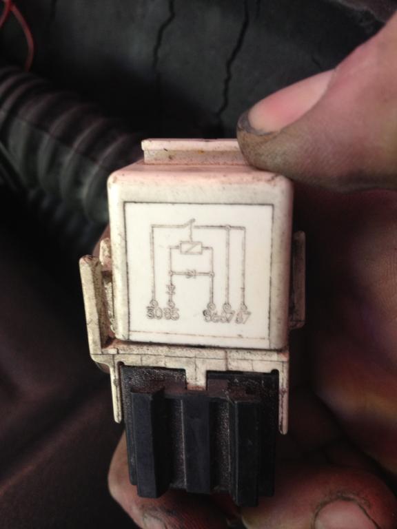

    there is power coming to the dme, i ran a test light. there is a few pins on the harness adapter that have 12v. 26 i think i specifically remember having 12v.
    The main relay clicks with the dme connected and ignition turned to run. if i disconnect the dme the relay wont click...i assume the dme powers the relay?
    i have no fuel pump action but i jumped the relay and the pump runs.
    i have voltage to 30 and 86 on both the main and the fp relay with the key on. i also have it at 85 when i plug the relays in. if i plug in the dme i get 12v coming out of the 2 red/white 87's on the main relay but not out of the green/violet on the fp relay. i hooked the ground end of the test light to the pin 8 grey and put the light to 12v. when i turn the key on i get no cel. bad dme? or is something wired wrong
