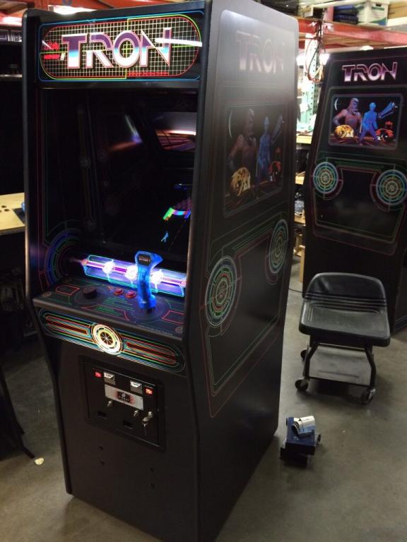

                              I'm restoring a Tron arcade game at work, is beautiful, like new, thanks for asking. Anyway, it also has a grey wire and a violet wire that used to go to the original power supply that had an R-C circuit that would pulse +5v on-off-on when the game boots and that would reset the ram and allow the game to run. Now that we have a switching power supply installed we no longer have that R-C circuit and the game won't boot. What we have found so far is that putting +5v on violet doesn't boot every time, but putting +5v on grey boots 90% of the time. We're thinking of building a circuit to replicate the proper timing sequence, or just the effect of clearing the ram, but there are other work arounds we will also try.
                              We'll see how it goes.
                              I know that has nothing to do with your car, but I have grey and violet wires and weird old technology to troubleshoot too. Good luck!
