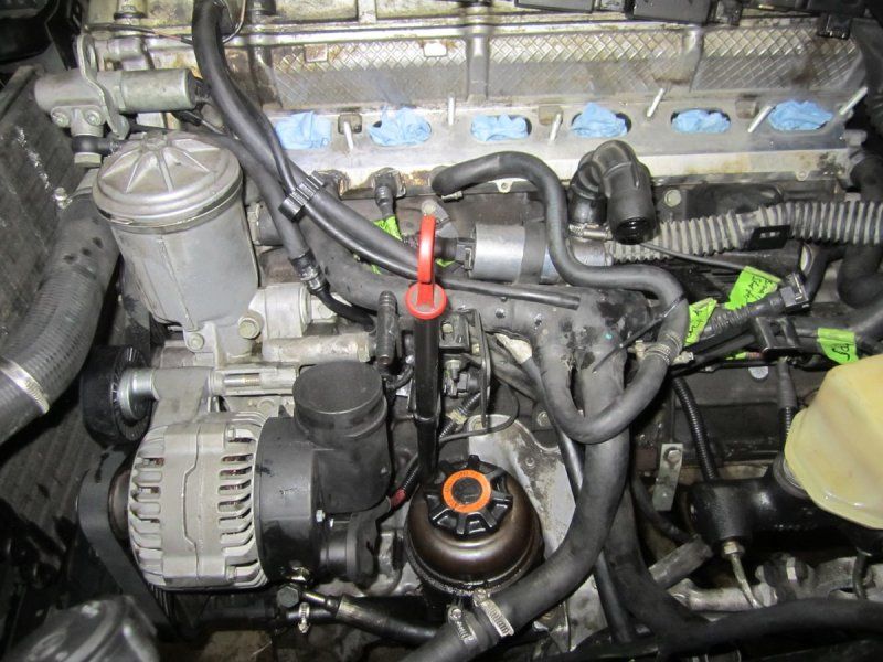

    After settling into the new house, we finally made the plunge, and decided on what swap we were going to go with. An M50TUB w/ zf tranny. I wasn't sure where to get something that would be both clean, reliable, tested, and at a good price. I eventually settled on Bavarian Auto Recycling. Initially, I thought they were great. Good responsive customer service, and they even assured me they would set me up with everything I would need for an M50 swapped e30. For the low low price of $3,000. Well I was stoked. At the time, I thought I was getting a great deal. Well...it turns out after I had paid them the $$$, they no longer cared. After getting my "pallet-o-engine"...I soon began to discover there were a lot of things I was going to need, and I also overpaid just a tad...and I suppose that's an understatement. Included with the swap was M50TUB (around 80k on it with all the accessories), zf450 transmission, new clutch pack, the brain, the harness, radiator, e21 booster, a transmission crossmember, motor mounts...and tranny mounts...now...on my invoice I was charged $200 for "drivetrain driveline reconditioned"? Don't know what that means, but I never got a driveline. I also could never get them back on the phone once I received my order...funny how that works yeah? There were some other issues as well, but those wouldn't come up until a bit later down the road. Well...after attempting to contact them several times both via email, and by phone, with no luck, I decided to cut my losses, and push forward.
    Over the course of 4 months, I pulled the old M10, began to clean the bay, and got the M50 dropped in. I had to work slowly due to my demanding schedule, and well the biggest reason, I had no idea what the hell I was doing. This was my first time doing anything more advanced than changing brake pads or throwing on suspension.
    Yes...that's a rope lol
    Easy does it...
    And BOOP...there it is, went pretty smoothly if I don't say so myself. I was pretty proud at the time. Pulling an engine was F****** cool! Haha.
    The bay all cleaned up
    Fitting and playing, no I didn't try to drop the new engine in with the rad in place...
    And she's in!
    Now...here's where I met a guy named Dave Markert (Markert Motor Works). I found him via the forums, advertising wiring harness conversions. Again, I had absolutely no idea what I was doing. So I hit him up, we began conversing, and I decided I would have him take my M50 harness, and combine it with the m10 one for a nice stock look.
    And here's what I got back!!!
    "This looks amazing I thought to myself"
    "I can't even tell it's not factory"
    Well..that's great and all, but again I hardly knew what went where. Well Dave helped me out, explained all the acronyms (even after he was cool enough to label every connection for me) and I was able to get the harness in place...sorta..
