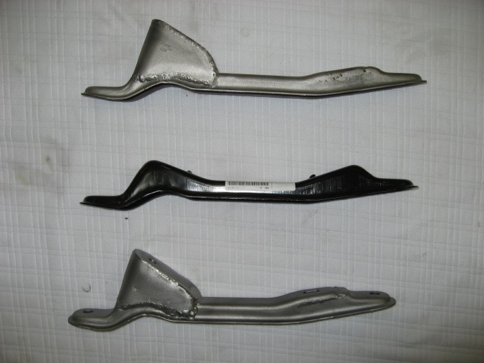

I know there have been several guys who have modified the stock one. Other guys have made their own from a cardboard mock-up. This is the DIY thread for a 24v brace. Post pictures/details/angles/measurements. Here are some pictures (not mine) to get you inspired.
This one appears to have no modifications done on the passenger side...
These look sweet
Modified stock (thanks Teaguer)
Here's my understanding.... If you plan on using the stock brace and modifying it here's what to do: flatten the passenger side. Mark how much material you took off. Add however much you took off to the driver side.
Feel free to add to this with your diy brace.
