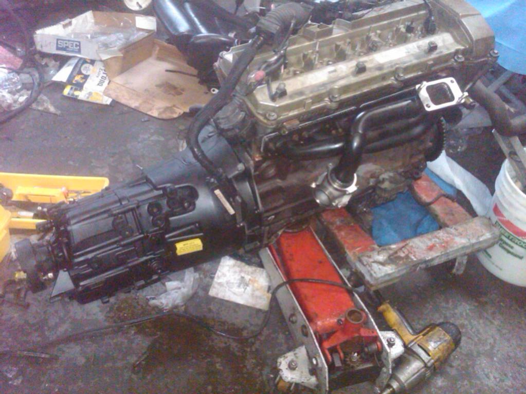

Im haveing a problem getting my shift linkage to work ,can any one please tell me what shift linkage set up To use ,what selector rod I have to use and the whole nine yards.i have a 1998 zf tranny can any one please help this is only thing holding me up from driving will post pic.soon
