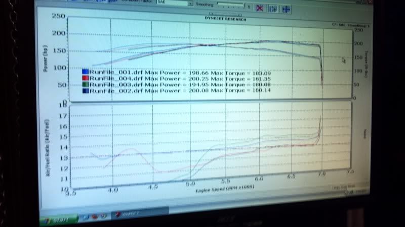

    Just dyno'd my e30 today
    OSR DYNO Tuning in Fontana CA using Dynojet
    specs:
    M52 OBD1
    raceland headers
    3" exhaust Borla (no cat)
    21.5 injectors
    3.5 AFM
    K&N
    14 lbs flywheel
    W.A.R. Chip (my own custom tune)
    Cometic headgaket & ARP head studs
    Running my Turbo cams
    200 HP & 181 TQ

    nice! I am doing an m52 swap soon. are you going for boost in the future? I ask because of the ARP head studs and head gasket.

      Def alot more to be had... Whats up with the vanos around 4-5.5k?

        Yeah I have my turbo kit already just wanna get all the bugs out with the swap 1st
        I adjusted the vanos to 5k with the W.A.R. just for kicks to see if it helps out or not

            Why not OBD2? makes more power, better for turbo too.

              OBD 2 = to much BS.
              OBD 1 + W.A.R. Chip = done

                  not really; OBD1 is garbage for brains in comparison- have you ever read the Wizard of OZ? i.e. scarecrow just wanted some upgraded brains>?
                  its even easier to:
                  remove obd2 ecu; send to TRM. re-install
                  no OBD1 required.
                  OBD1 is for junkyard poopsmith hoarders. so are OBD1 engines IMO.
                  Use the proper modern brainpower designed by BMW for the engine.
                  I can see the desire for OBD1 if all your parts are going to be from the pucknpill poop yard; but I cannot relate

                    Well that's your opinion I'll stick with OBD 1 & tune it myself I have now done everything to my own car

                      Hey not bad. How much did they charge if you mind me asking?

                        $65 for 4 pulls no tuning. I heard He's having a DYNO day this month $45 for 3 pulls

                          war chip sounds like fun. how many tuning variables do you have control over?
                          also when you do bewst, what turbo do you think you'll use?

                            The war is fully tunable from idle, p/t to wot timing & fuel vanos control launch control the whole 9 yards. I already have a rotomaster Garrett t3/t4

                              ^wow, that's fairly comprehensive. good luck on the build and please.. post pics!
