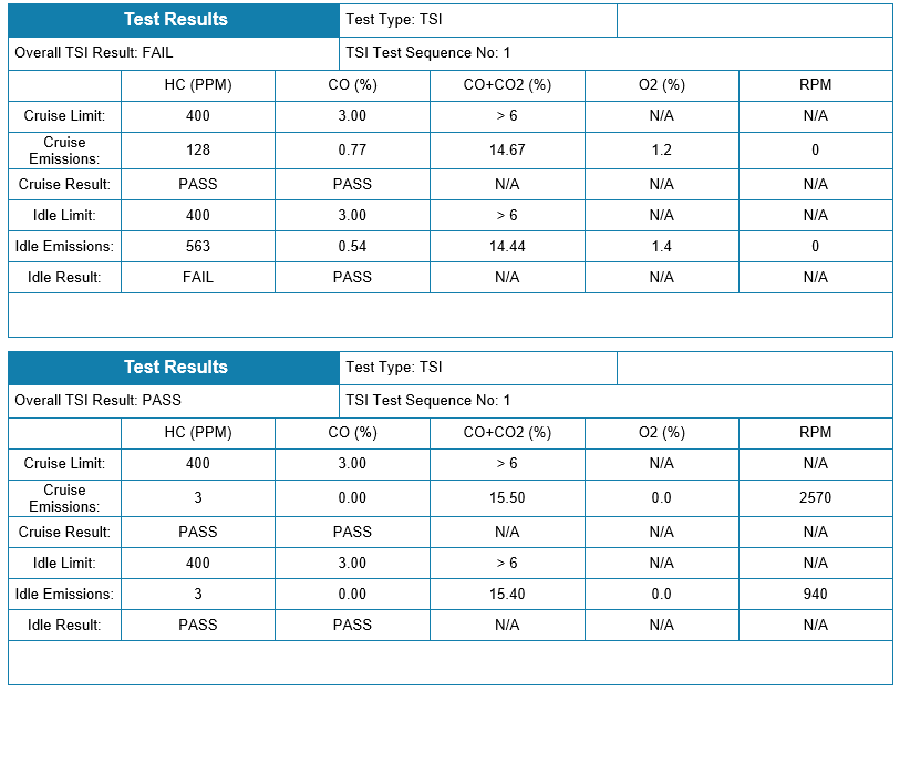

                                #45
                                Passed!
                                In case this helps anyone else, I ended up adding a second cat. The Magnaflow one was apparently worthless because when I put in the Walker 80301 and retested, it passed absolutely flawlessly. Only drawback is the Walker is 2" in and out, so the shop had to open it to 2.5" in and out to install it (no big deal- install was $88.)
                                Before and after:
