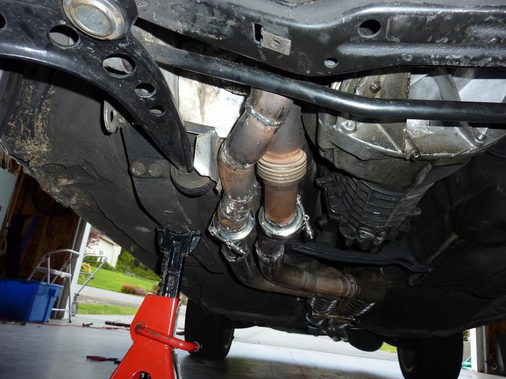

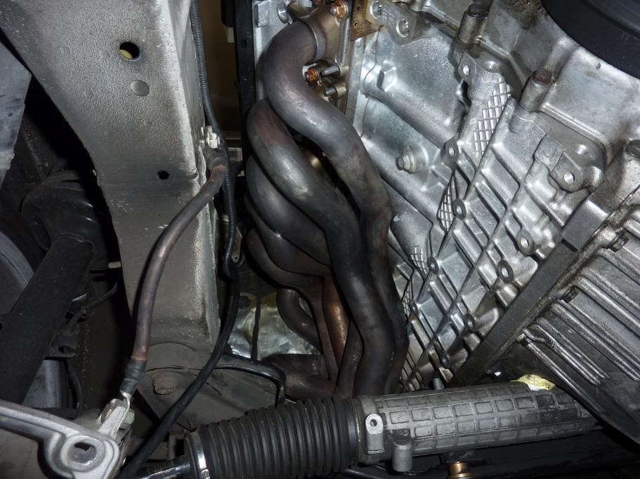

            Instead of making the car fit the headers, I made the headers fit the car...
            Aluminum block also has some bumps, protrustions and seems slightly thicker than the iron block which made it more challenging.
            These headers made slightly more power than the OBD2 set that they replaced, but that's partially because I could program in some more retard on the exhaust cam. The difference in power was mostly in the 2500-3500 band which suprised me.

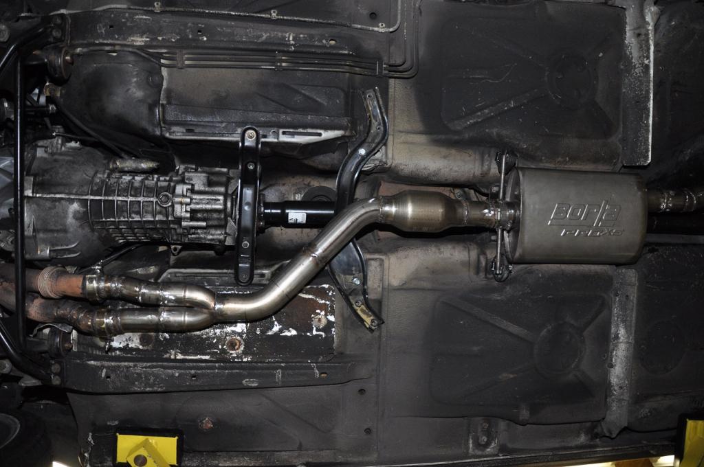

                Later upgraded to Borla exhaust, this shows the routing and clearance much better. The unmodified headers would have hit the CAB and sway bar badly!
                I love that with the V-bands I can remove my entire exhaust in about 2 minutes!
                • madsedan
                  • 222
                  Is that 2 1/2" or 3" after the 2 to 1 merge?
                    2 1/2"..
                    Yes, I know I could have gone with 3" and it wouldn't have been loud, etc. etc but the M54 is a dog over 6000 stock so what's the point?
                    I'm hitting 227whp and it sounds great!

                        • hoveringuy
                          • Dec 2005
                          • 2722
                          Originally posted by RedDotRacer
                          How close to the sway bar? Its hard to fromthat angle.
                          In the picture the exhaust is touching the sway bar, but that's because with weight off wheels, the sway bar rotates down as the wheels drop.
                          In practice, I have 5/8" clearance.
