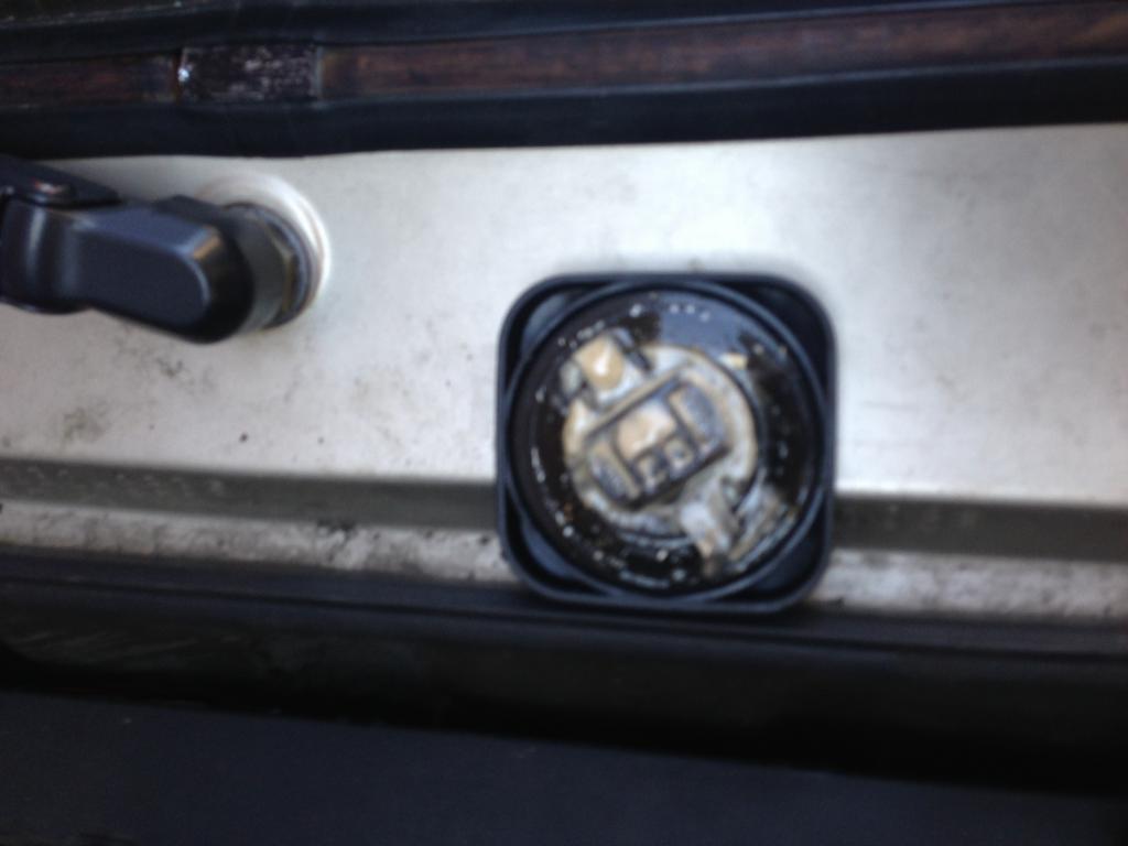

          I opened his oil cap and this white slime was there and really smelled horrible

            Is the rest of the oil mixed like that? Blown head gasket.

              The cap is from normal operation of these engine with moisture mixing with oil
              Unless the level of coolant is going down... Then headgasket or cracked head/block could be issue

                Idk I drove it and everything seems fine, how do you tell if you're head is cracked/block. I did the swap for him and the motor looked good
