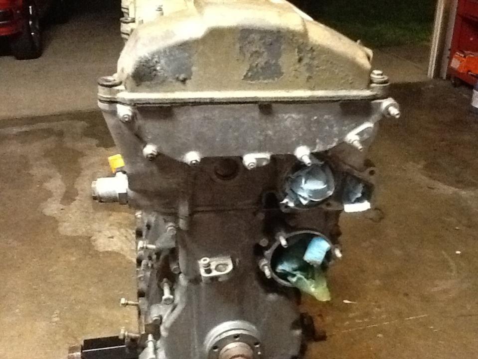

                      Here is the m50nv with the cover plate were the vanos goes. It seems like a straight bolt on
                        Originally posted by amcink View Post
                        Robertk
                        Sorry for the late reply man, The bolt pattern matches right up but there is part of the casting on the intake side that has to be notched to clear one of the bolt heads on the vanos unit.
