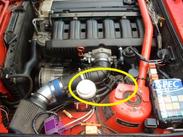

Where do you guys get these brake fluid resoars, and the couplings to the MC?:roll:

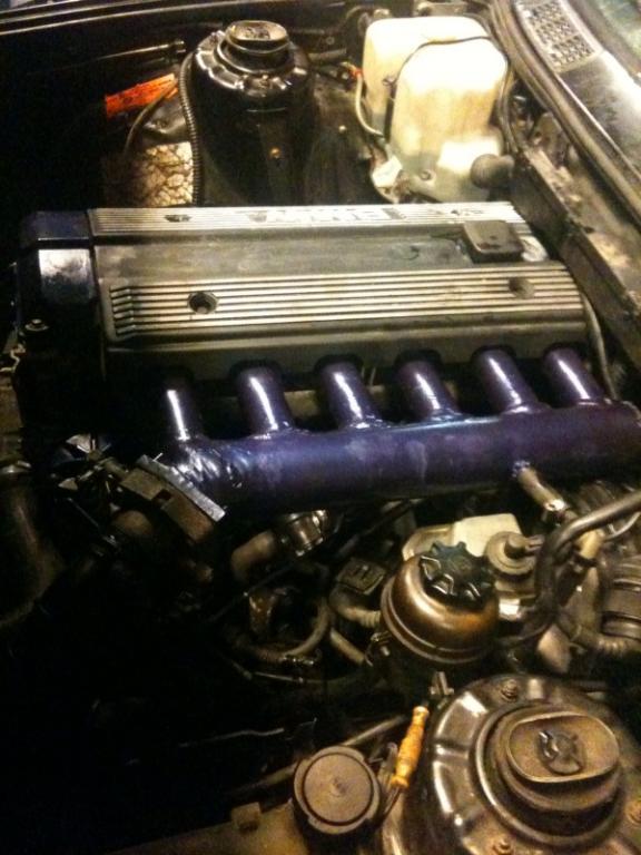

By the way... The begining of my 24v ride:-D 325IX With 4WD still active8) The intake manifold is to be changed out with OEM as soon as i can ged the HydroBrakeBooster up and running;)

Mine's from a 2002. I'm pretty sure this is the correct PN for the connectors (hose to MC) 215 211 516 97

Regretfully no, this is not the first. But very awesome, the power gets to the ground even on solid snow:pimp: To bad the engine gets tilted even 10 more degrees to the drivers side, thats what the intake fuss is all about

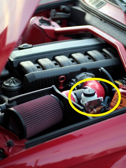

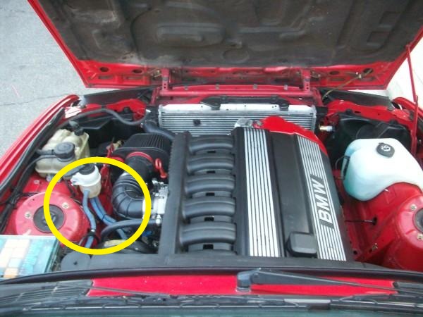

The reservoir pictured is a remote reservoir out of a 2002. Personally I used some low-pressure brake line (blue stuff pictured) and 90 degree brass fittings to couple it to the master cylinder:
