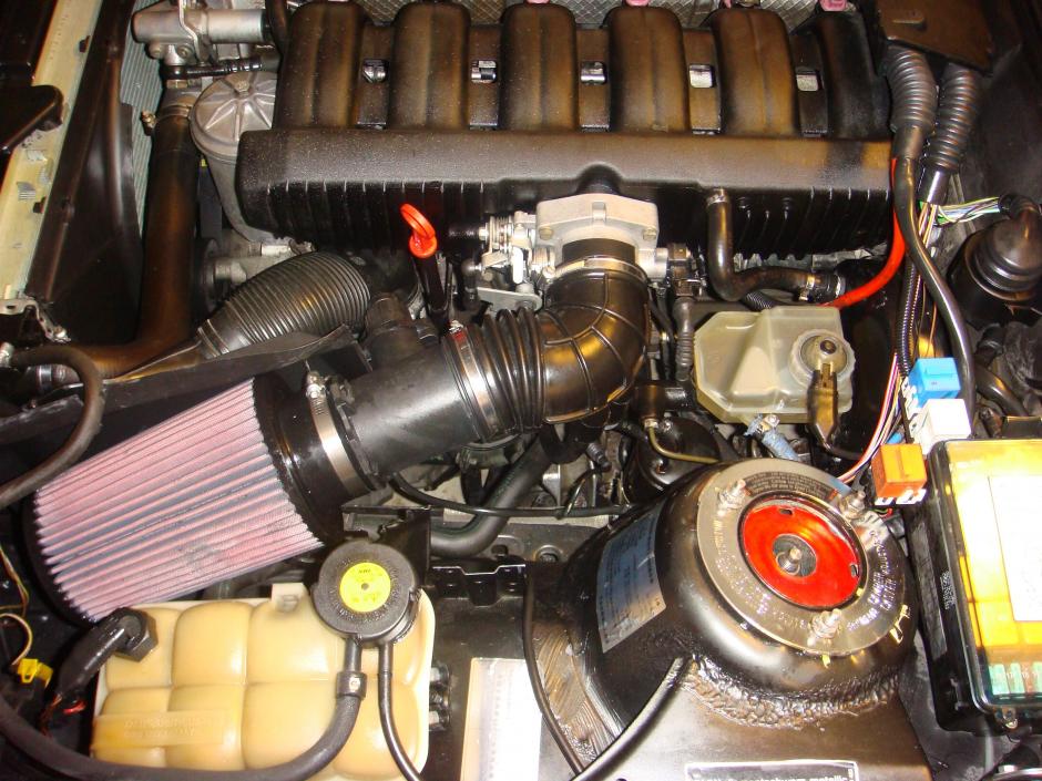

      1991 320ic w/ S50
      Finally have some engine bay pics...

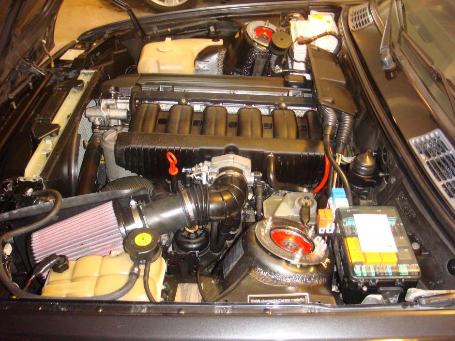

        few pictures
        finally finished my swap after 4 months of unexpected rust repair. no intake yet still have to buy one of those.
        still need black front seats and speaker panels of course
        1996 S52 with ZF transmission Z4 shifter all new bushings
        E34 m5 clutch with 8lb aluminum flywheel
        E28 3.25 LSD
        Custom 2 piece drive shaft from Atlanta drive line services
        E36 radiator
        E28 mounts
        E21 transmission mounts
        Stewart water pump
        413 red label with OBD1 S52 21lb program
        98 E36 M3 steering rack with new e30 inner and outter tie rods and boots
        OBD2 S52 header with Supersprint midpipe and stock E36 M3 cat back
        make shift suspension till i get coil overs or go five lug (stock suspension was completely shot and needed something
        Tokico shocks with H&R sport springs
        and of course all the new pieces on engine and interior replaced that all add up $$$
