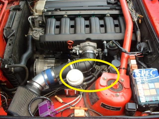

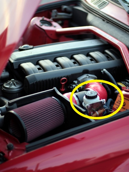

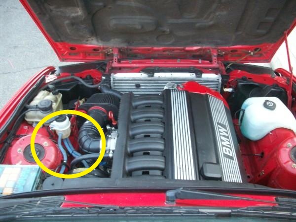

                    Where do you guys get these brake fluid resoars, and the couplings to the MC?:roll:

                      Mine's from a 2002. I'm pretty sure this is the correct PN for the connectors (hose to MC) 215 211 516 97
                            The reservoir pictured is a remote reservoir out of a 2002. Personally I used some low-pressure brake line (blue stuff pictured) and 90 degree brass fittings to couple it to the master cylinder:
                            But there are other options to go with as well.
