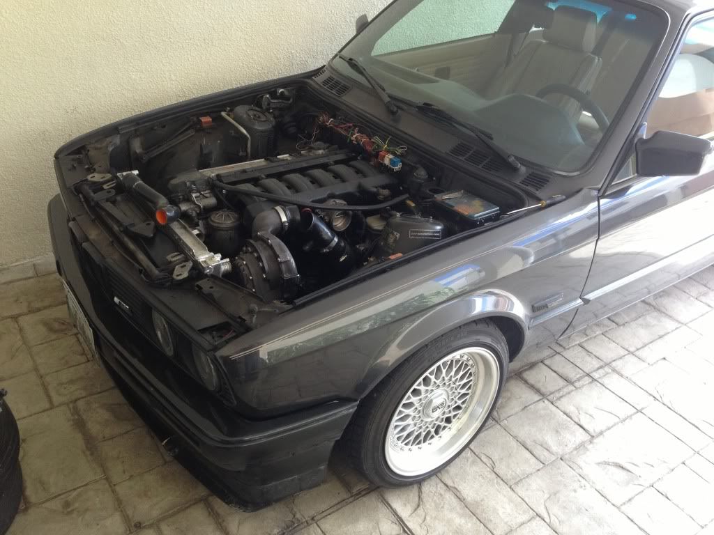

    here are some pics of my car, getting there...
    Thanks

              Nice! I have an e36 radiator, so I did have to mod the oultet

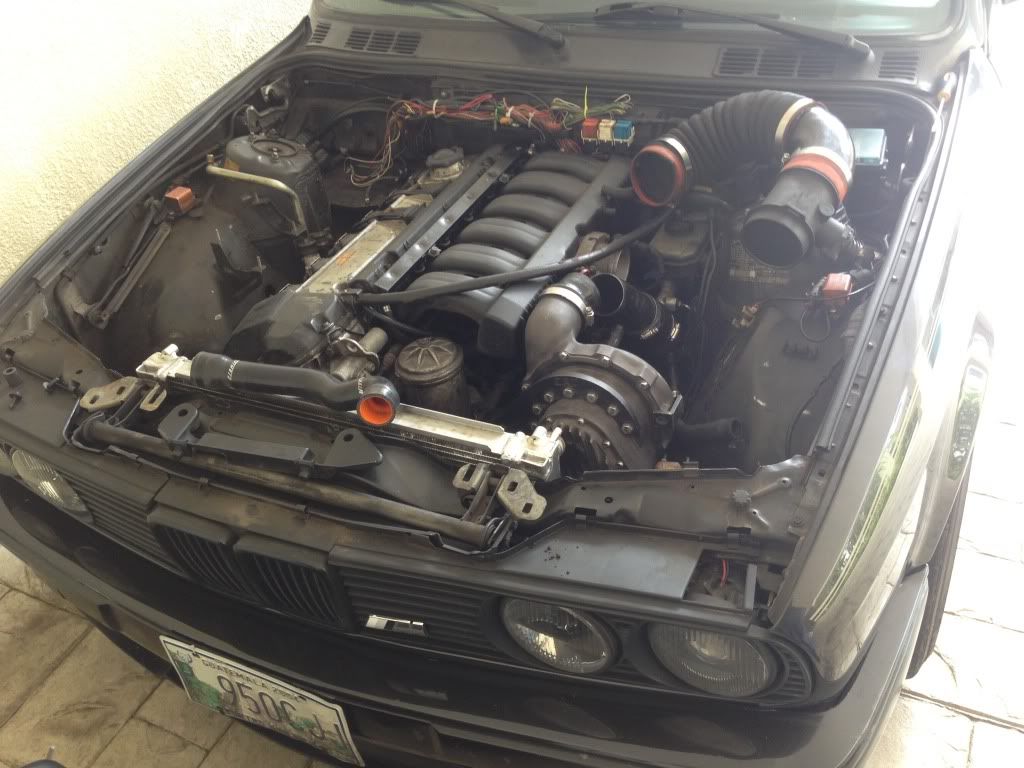

              supercharger hit the abs pump, i will just relocate it about 1" to the drivers side by making a custom bracket out of the stock one, I just haven't finished that part yet... everthing else fits fine :D
                here is a picture of how it will look all together...
                tight fit, but it should fit with the hood closed, I still don't know which air filter Im going to use..
                  Awesome,thanks for the pics as I had visions of relocating the coolant tank and possibly deleting abs.I just installed the same rad last week after the oem unit failed,I'll be doing the same upper outlet mods,fitting the 3.5" MAF and a filter is going to be tricky.
